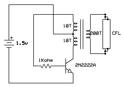

      • Originally posted by African View Post
        Hi Janost
        You stopped updating, how long did it run?
        Can you please share the circuit that you used i would like to try it if i may.
        I would appreciate it if you can.
        Thank you.
        It stopped after 146h.
        This is the circuit that I'm using.
        • Hi Janost
          That is impressive and the circuit is nice and easy to build.
          I am going to build it right now.
          Thanks for sharing your circuits so freely they are mostly easy and very practical, most of the parts are readily available and easy to come by
          Best Regards
          Johan
          • Hi janost
            Is that an air core or ferrite?
            • Originally posted by Zardox View Post
              Hi janost
              Its a ferrite core.
              • Just make 10turns, a centertap and then 10 more turn on a ferrite rod.
                On top of that make 200turns for the secondary.
                If you are lazy just take a tennis-racket bugzapper.
                Remove all bleederresistors, diodes and caps from the secondary and connect the CFL to the HV-transformer secondary.
                Run it with a 1.5v battery.
                Its the same thing.

                  • hi janost. your latest schematic does not include the diode return to battery -. i would have thought that to be an essential for an endurance test.
                    also in pjk's final testament there are at least a couple of items that pertain to your recent efforts,if you haven't read them already. 6-31 page 405 has some encouraging info on grounded jt's and 6-33 page 407 refers to serious car battery charging with an avremenko circuit on 1 end of the secondary and the other end open.
                    lotsa good stuff in there including pjk's own jt version with a claimed cop of 1.8.
                    i'm gunna get me a proper earth connection.

                              Yes, a diode between the basecoil and minus battery works.
                              I have never used it on any transistor JT's so I just forgot to put it in.
