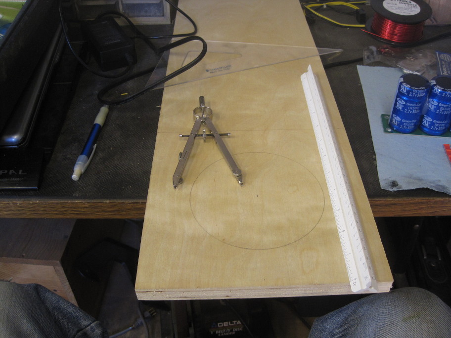

                            • OK, some progress. I got the antenna wire and the supercaps in today. I charged up the supercaps slowly from my bench power supply and checked the voltage on each on cap individually to make sure the balancing logic works. It's not perfect, apparently some of the caps have more or less capacitance but the differences are minor. I ran the PVM12 briefly off the charged caps to verify that that it works that way.
                              I also started the mechanical design and layout. I think the whole rig should fit in an existing weatherproof battery box I have that is about 30x30x12 inches. The box used to have deep cycle batteries from a small off-grid solar power system in it, but that was some years ago and the batteries all eventually went bad and got recycled. I didn't have $2000 for new batteries, so I decommissioned the system. Hopefully with this research I won't need deep cycle batteries ever again. I cut the baseplate from cheap 1/2" plywood, this will be more like a boilerplate rig than a really pretty build. It should at least look better than the jury-rig bench layout does. I also laid out and started cutting the end supports for the L1 coil, I think it makes the most sense to lay it out horizontally. My idea is something strongly resembling Don's "tabletop" rig, with the resonant coils in the middle, input circuitry on one side, and caps and output circuity on the other side.
                              As usual, I'll put full resolution versions of the pictures on IPFS but that takes a little while, so for now you can see the scaled versions immediately.
