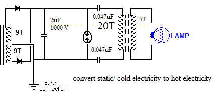

    • Originally posted by zilano View Post
      do this thing as below in the figure. at 1000 volt the capacitor will fire spark gap.the .047 uf cap is rated 1500 volt and is not electrolytic. dont use electrolytic capacitor.
      my setup is step down transformer that is mean the low voltage in second coil and the cap take more time to full charge of 1000 V to active the sg
      i am not test it yet.

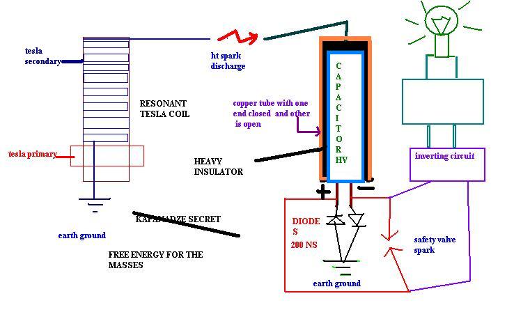

      • Kapandaze Secret
        This is the Zilano Kapandaze diagram we've been looking for!!!
        Thanks very much to my contact in southern part of US for providing it!!!
        Best Regards,
        David Fine

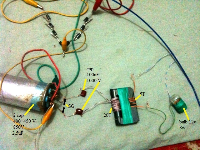

          hi all
          hi zilano
          that's strange
          the capacitor charge up to 750 V and sg distance 1mm but it don't spark.
          i activate the spark manually by short the 2.5uF capacitor many times rapidly but no results no light from bulb.

              • Originally posted by Eng.raied View Post
                hi all
                hi zilano
                that's strange
                [ATTACH]11325[/ATTACH]
                u r getting very low output so adjust resonance. there is step down no doubt but not so much stepdown should be there. u have to adjust resonance.
                        what about this
                        please more info
                        serial with what?
                        if serial with 2.5 uF cap that no loop to discharge .
                        just adjust resonance of primary of ur coil with secondary output coil. ur output is too low it shouldnt be.
                        rgds
                        raadawad
                            please more info
                            serial with what?
                            rgds
                            raadawad
                            the message i posted of neons is not relevant just adjust resonance first.
                            i meant neon bulbs connected in series in place of spark gap.
                            but first u have to adjust resonance.
                              ok zilano
                              what your suggestion about adjust resonance ?
                              using rules of length of L1 with L2
                              or using force resonance (cap +coil)?

                              • Caps
                                Hello Zilano,
                                Please explain how the section highlighted in the attachment works.I mean the two small caps with the tranformer in between.Why that size caps (0.047 uf) What action is taking place here?
                                Attached is also something I wish to thank you for explaining, sometimes it takes a while for understanding to dawn....
                                Keep up the good work Zelina.
                                Ged
