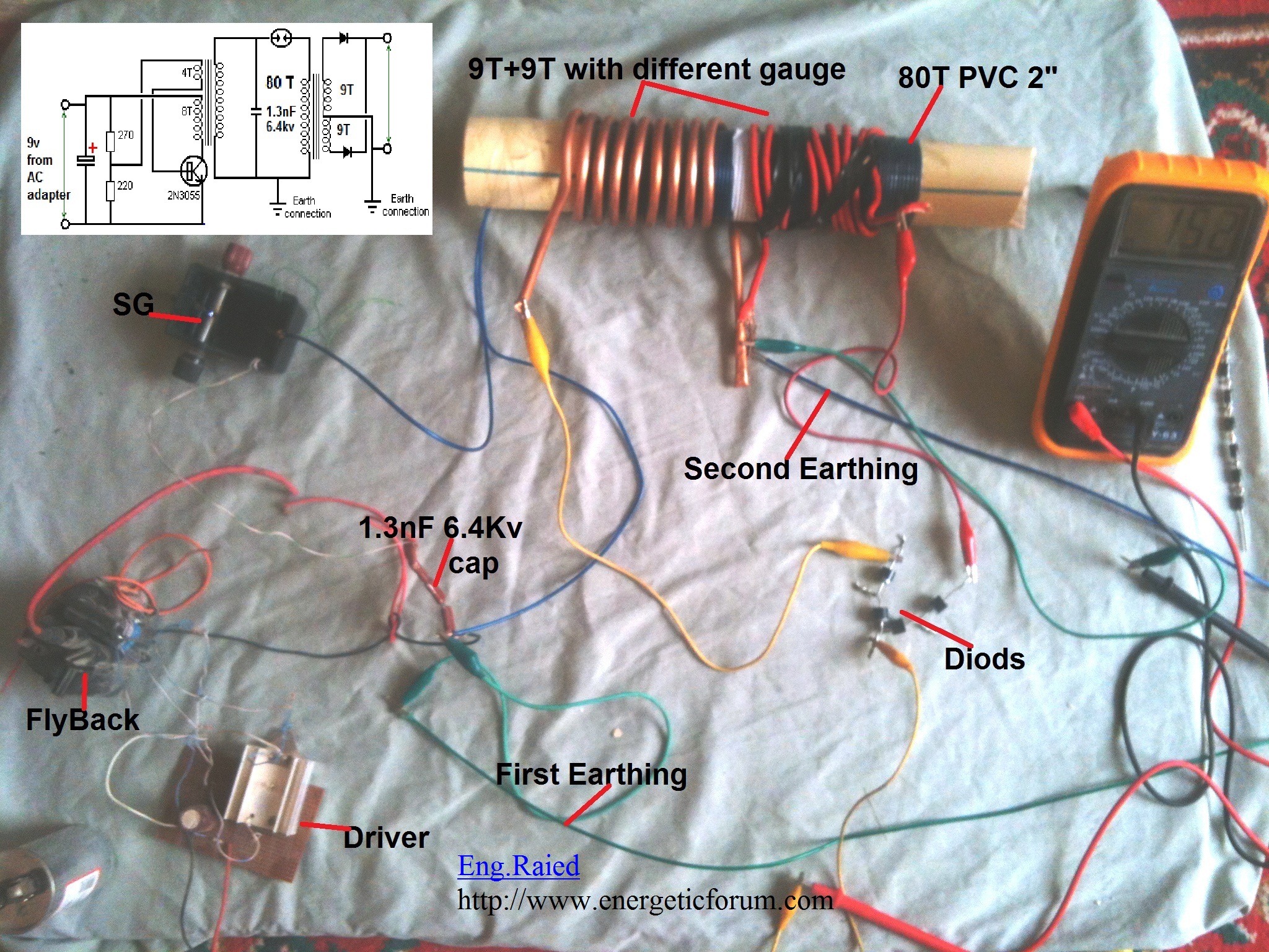

          hi all
          this my setup:-

              • @Eng.raied you made a measuring fault.
                I followed your amps video and plan and there is no output resistor as load. It is needed for measuring and calculating the output power.
                Put the load parallel to the output (center tab and diode bridge in your case) Measure the amps in series with the load.
                Even better : Put an cap across the load to get a smoothed DC.
                Try a few resistors as load and chose the one resulting with the highest power.
                The short circuit current is not of interest! But you measure it.
                (and even used it for calculating output power ; and this is wrong)
                If your fbt is driven by the resonance freq determined by the 1.3nF Cap and the fbt-secondary the
                voltage in resonance on this cap is really high. This is an AC-driven spark gap .

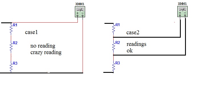

                    What happens when you put a 2 watt resistor across the output terminals? A 5 or 10 watt resistor is better if you have one. Any resistance value will work. If it does not vaporize, what is the voltage across the resistor?
                    when i put across 3 resistor the reading wrong
                    but on mid the reading ok like the pic
                    FREE ENERGY = FREEDOM
                    raadawad[at]yahoo.com
                    eng.raied[at]yahoo.com
                    • Originally posted by Eng.raied View Post
                      [ATTACH]11281[/ATTACH]
                      OK. That is strange.
                      The voltage from the output coils is AC so it should be possible to put a capacitor in series with each of the output diodes between coil and the diode. This will block DC in coil. Adding a capacitor in parallel with the output resistor will convert the pulsed DC coming from the diodes into a more constant DC voltage. This may solve problem. What kind of output diodes are you using? They may not be fast enough for the AC coming from the output coil.

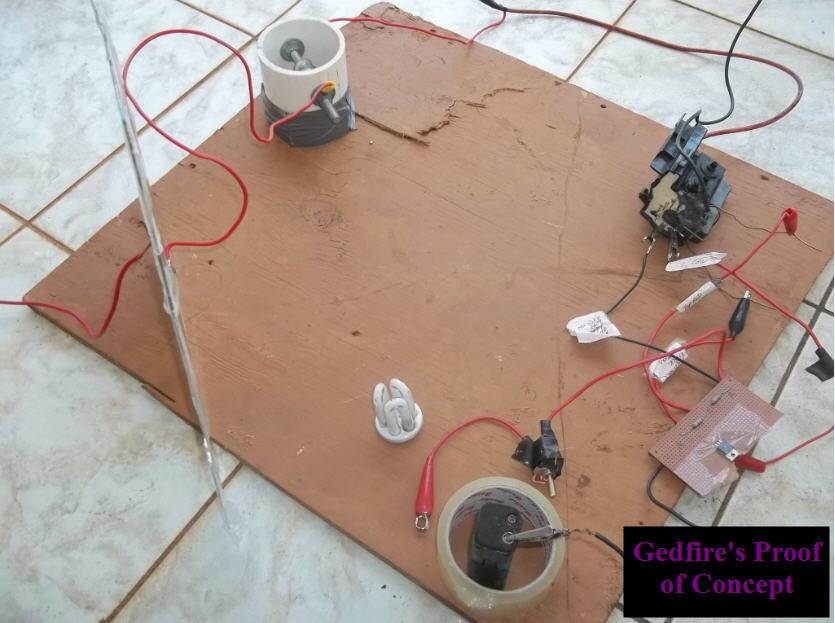

                              • Proof of Concept
                                Hello All,
                                Hope you are all making some progress.
                                Did some experiments today using a concept proposed by both Zilano and Don with a little modification.Not the neatest set up, but had me saying hmmmmmmmm....interesting.No champagne yet though until exhaustive tests are complete.
                                I have lot of mods to do,ie: avramenko, tranny, light bulb, etc.
                                I would appreciate any suggestions,comments ,questions you wanna make/ask.Go ahead.I have some too, like making sure that super flyback is well insulated and that the glass and tape did not let electrons through from the live wire.
                                Did a some amount of fooling around.Perched on a two inch thick rubber mat with rubber slippers on,I lefted the ground from the floor.There was a change in the chattering from the spark gap.It dropped in its noise and the flyback ground came to life as the electrons desparately seek another route,arcing i suspect was taking place too.When the ground was replaced on the floor, high noise.DMM measure static energy voltage current and frequency from the GROUND wire.I took a risk placing the limited DMM on the ground section.No fuse burned.Happy to know its possbily low voltage on the output.Wonder what will happen when I make a bigger cap?
                                Gonna try this on two deep earth rods I have at my work place that I had used with Naudin's Kapagen many moons ago.
                                Will keep you all posted.
                                Best regards,
                                Ged
