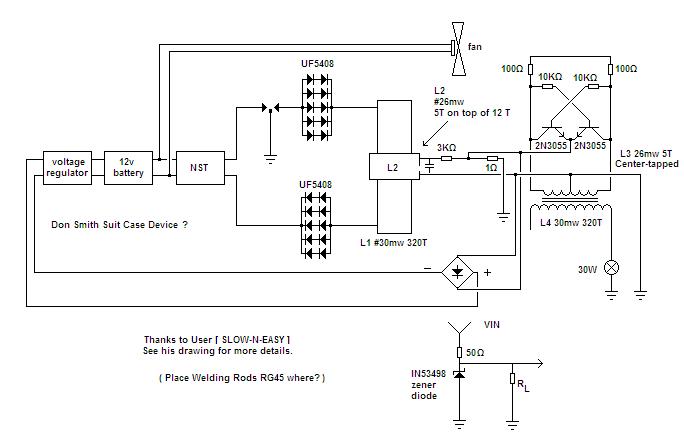

    please review your schematic and answer the questions. Post a picture of your coil , if you did it manually describe diameter and length of both coils.
    He references a plug. Looks like one side goes to ground and the other back to the transformer. What appears to be a single wire to the bulb is likely an extension cord.

      Hey Johnstone
      I have some answers to your question on your pdf.
      Battery:sealed lead acid
      Brand: Tysonic 12v 5 amp
      Transformer:Liteglow Industries
      1291 sw 27th ave
      Pompano Beach , Fl 3306
      1 800 801 4569
      LowGlow series
      12 volt 5 amo input
      9500 volt 30 ma output
      40 khz
      Spark Gap: (3) copper eletronics adjustable holder
      3 post per spark gap usind # 10 bare copper ground wire
      1" or 25 mm long
      Coils:minni bobbin purchase from allelectrics.com
      plastic bobbin 4 post ready for circuit board and soldered
      L1 4.89 turns # 26 copper mw mounted on top of L2
      L2 310 turns # 30 copper mw
      L3 310 turns # 30 copper mw
      L4 4.89 turns each # 26 mw (1) cw (1) ccw on top of L3 center tapped to ground
      Wire: purchased from Allelectronics.com
      # 30 & # 26
      Enameled magnet wire
      Cooling fan: 12 volt 40 mm
      Sunon Maglec# kde1204pfv2
      1 watt
      40 x 40 x 10mm
      7.0 cfm 27 dba 2-2,3" leads
      Welding Rods:1/4" or 6mm
      Copper Coated SoftSteel Core
      Howbart Manufacturing
      Purchase from TSC Hardware
      RG45
      Lighting: 30 watt
      Floresence
      110 volt
      inclosed in lamp holer
      Hope that wath youneeded for your pdf
      Good Luck & Best Wishes
      SLOW-N-EAST

      • Cord
        HI EMCSQ
        THE PLUG I MENTION IS METAL ENCLOSED LAMP WITH CORD AND PLUG
        I JUST I WIRE GOING TO MY DEVICE OUTPUT AND THEN A EARTHED GROUND GOING TO ROD DIVEN IT THE GROUND OUTSIDE THE HOUSE THROUGH DRYER VENT THAT I AM NOT USING.

        • Originally posted by JohnStone View Post
          Hi ALL,
          all published specs for the replication from SnE (Thanks for sharing SnE!) I am aware of were gathered in a PDF doc.
          There are lots of open questions to be answered. I intend to save this specific information in one doc in order to prevent fading out by the plurality of posts
          @Slow-n-Easy: Thanks for your sharing. Please read the doc and you might be able to answer some questions. Please PM me how you would like to do that. My recommendation is Isend you the original word doc and you write your notions directly in this document.
          @ALL: If you discuss details it will be helpful if you refer to the specific building blocks listed - in order to add notions precisely in this doc.

                    • HI
                      the shematic is ok the oscilator for 60hz is like this you may find in the old converter from 12v to 110v this is basic simple ciruits and block shematic and is true ... but all here is missing here all this devices << T.K D.Smith.. and athere similar to >
                      what is vrong in this shematic nothing all is there all is here .. but is not working like <cop 1.>2 or more
                      all this years you may turn and turn around and still waste time ...
                      i say is the raid way to make don smit device whit this sheme.. if some one find the something is missing then whill work just very powerfull... .. and stilll whill be keep in the secret box...

                            • inverter
                              Originally posted by SLOW-N-EASY View Post
                              Howdy African
                              I'm Still working on it to get the bugs out.I'll work on it tonight on that particlar part of circuit. Also
                              I have added a cap bankr to the device (5) .01 uF 4000 volts each. and its working great. If anyone
                              has a device that flshes on for a second and then shuts down and keeps repetting. you need to switch the leads , one one
                              to ground and one to rhe plug you are trying hope this this helpssome. I just found that out while
                              working on device.
                              HI SlowNEasy thanks foe sharing this schematic. Regarding transformer an MOT would be good just add 10turns ct? and what one should do for 50hz output?
                              Thanks.
                              • Originally posted by SLOW-N-EASY View Post
                                Howdy African
                                It is still confusing on second part where transistors are in flip-flop circuit. You are feeding in AC pulsed signal into that part and transistors only work correctly on DC power... Is it missing rectifier bridge before transistors?
