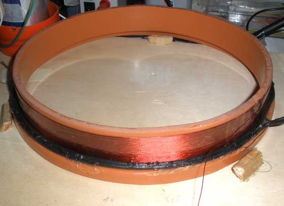

                      • Hi all
                        Big problem with acces to the forum today ???
                        Hi Dragon
                        I have understood one of my problem with the grounding (at the output of the secondary). This is due to the fact that i put the 1 ohm resistor at the positiv of battery to measure the current with the scope. So i intruded the ground of the scope into the positv and it perturbated all the measuremt once i connected the real ground.
                        So do not try to use a measuring shunt resistor on the positv of battery while connecting the ground on the output of the secondary.
                        Than i was happy to receive my LCR meter today back from repair, and i could measure the capacitance of my home made variable cap. So as you can see it goes from 30 pico farad up to 104 pf. I can vary the capacitance by in creasind the thikness of the dielectric.
                        Than i wounded a third flat big kacher with 50 turn of 0,4 mm stranded wire (7 x 1,5 mm ) and a 2 turns pancake coil primary, Which works also really well.
                        So guys a lot of tuning but i can assure you that once you have the device in front of your eyes and playing with it with your little fingers , you will learn a lot , and perhaps in a very near future, i will be (as i try very hardly ) able to comprehend the words of mister Dragon.
                        And if ,i miss , it is not a big problem , i will insist , or wash my brain by changing the game , and why not coming back on the subject in some time with more other experiences which can perhaps open my eyes something more and be finally able to catch it,,,,,....
                        good luck at all
