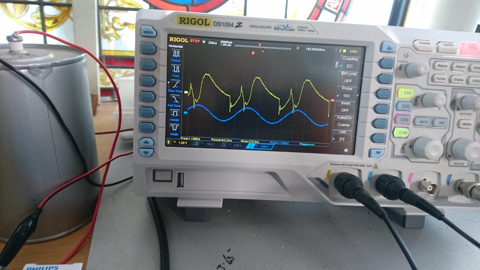

    Thanks for the advice. I get what you are telling me. However, I do not seem to be able to see the wood for the trees! I am using the scope to look for incremental increases as I adjust the position of the input to L1.
    The image I get on the base of the transistor, I am not able to quantify such that I understand the strength of efficiency of the feedback from L2. Also, I am not sure what I will see if there is resonance!
    Winding direction is a good tip. By pure luck I have two L1 coils with different weights which are CW and CCW. If my L2 is CW, I should be using CCW L1 to my mind and with the negative connection at the bottom of the coil. Small issues, but important. Haven't tried the arc length, will look at that tomorrow. Off to bed.
    Also, I am only running at 6v and my current changes greatly about the centre point of one of my L1 coils. I have a tip31c that I am using and it gets quite hot. Double the voltage quadruple the power! Blow the Tip off!
