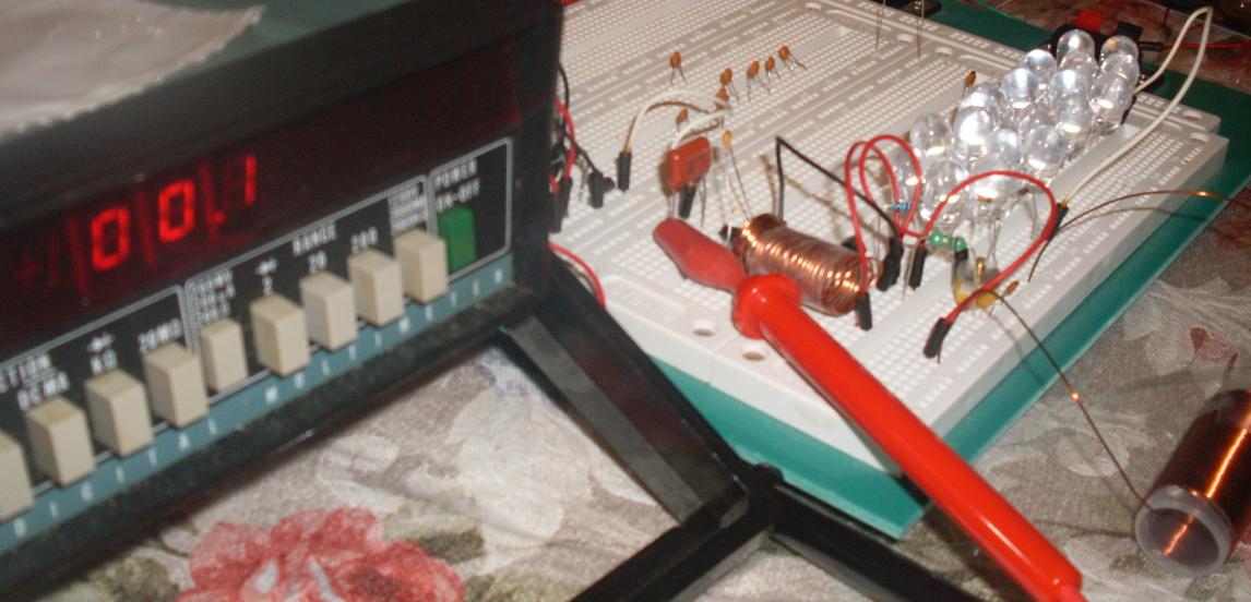

    • Originally posted by mlurye View Post
      Eric,
      A picture of a circuit I built with parts were used is here: http://www.energeticforum.com/renewa...html#post53048.
      I used 2 coils because I was lazy to make new ones and tried to use what I had.
      Thank you for a very fast answer.
      I don't think I stated clearly, that the thing I was asking for is a photo of your physical circuit, not the symbolic diagram, as I saw this already. I ask for it to see details of physical locations, wire lengths between components etc.

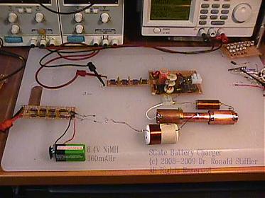

                      • Battery Charger
                        @All
                        Okay lets get the solder guns out and do some testing. I will attach a diagram of a battery charger that works and is CEC>1, BUT it has a problem, it works to well. It will charge the little 8.4 NiMH batteries in minutes. Problem is I fell sure the batteries are going to have a very short life. I do not have data to support this one way or another, this is where you all could obtain data that would be of great value. "You will need to read up on and understand batteries a bit" or the info you obtain will be inaccurate.
                        I posted earlier a simple diagram of a charger, this one works from an SGate and is fast and effective. The charge rate can be adjust to 20C, my feeling that 10C might not even be so good in the long run. Yet the numbers may be that they could be replaced as needed and show a faster recovery.
                        You would need two to run the exciter at 18V, exciter will charge one at a time, yet overall outcome is good.
                        The SGate diagram is already posted, grab a battery and letssee......

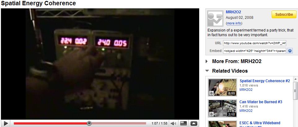

                        • Hooooh that's the explanation of the burning feeling along the FL while runned by the SEC ! They radiate much RF !
                          So we have to use other kind of light; what about doing like in your video YouTube - Spatial Energy Coherence with an old style incandescent bulb ?
                          Is it replicable without the water ?
                          The 2 SECs look like taking around 24V x 20 + 50 mA = 1.68W
                          The bulb is a 7W I presume, if lit at 70% = 4.9W;
                          that's 3.2W gain = 66% gain !!
                          We still in the high gain zone, if my estimations are correct
                          Much warmer surroundings with incandescent light that the cold FL (just my opinion)
                          If not we have to go with LEDs (way much more efficient), but we will need a small number with high brightness to reduce the production costs no?
                          I suppose we can also get high brightness on LEDs by using 2 SECs, no?
                          Very interesting and practical talk Dr.
                          thanks for bringing light to our wonderings
                          MDG
                          PS: I took a still frame at the very moment after you opened the second SEC, then you moved the camera down to the SEC, but may be the input values didn't change after that moment.

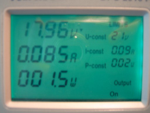

                                OK, after my first stupidity, I have now tried to build a SGate.
                                The replication is a bit harder, as no shops for building materials near to me has copper tubes for sale.
                                The last few years they have optimized that away for better profit.
                                So I used the tubes I have, but they are not the same dimensions at seen in the thread.
                                I had to somehow find a way to do the dimensions of the SGate with my 18 and 28 mm copper tubes.
                                If I have understood Doc's directions correctly, I should replicate the 15pF balanced SGate.
                                I have looked at the SGate pictures to figure out what the design principle is.
                                My guess is the masses of the two outer tubes must equal the mass of the center tube.
                                So first I adjusted the overlap of the tubes to get 15pF capacitance, that was 80mm.
                                Then I got the weight of the 28mm tube to 64 grams. So 2 tubes are 128 grams. This equals an inner tube length of 275mm.
                                Collector to middle inner tube, ground coil to the left outer tube. AV plugs to right outer tube.
                                After some tuning I got to this first result. It is not correctly tuned, as it consumes 1,2W.
                                The two AV plugs each 15 LEDs are blinding bright at max intensity, and my Weller temperature controlled solder station
                                flashes its led randomly instead of the regular blink frequency indicating correct temperature.

                                The 3 pictures attached shows the replication, the display of the power supply and the scope shot.
                                Upper trace is the base signal, the lower is the signal from the right outer tube measured by my 1000:1 high voltage probe,
                                so the peak-peak value is approx. 160V.
                                Just for tuning I can remove the scope probes an just place the HV probe 1cm from the right outer tune, then it pick up the signal anyway.
                                I have had consumption down to 0,8W shortly, and shortly after the picture taken I got stable 1.2W.
                                It can be seen from the "sine" that the tuning is not bulls eye, there are a higher frequency overlaid.
