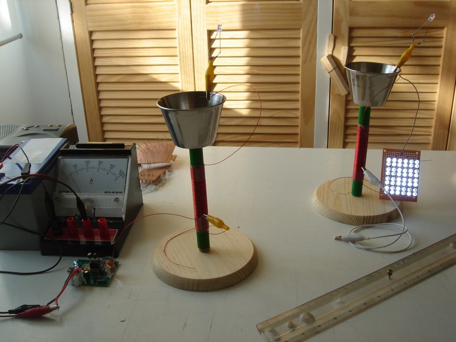

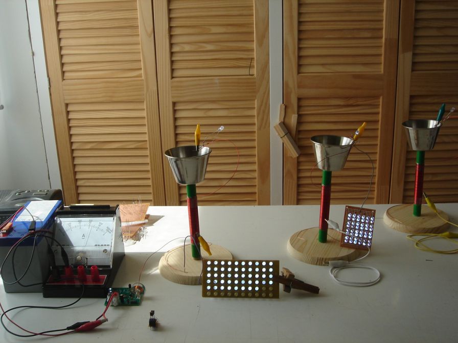

          Hello again Dr. Stiffler
          I checked the sniffer coil, wow, too much there all around, although understanding it correctly is another history.
          I have build some wireless towers, I have not been able to find exact measures as described on your instructions, they worked seamlessly, but results may differ from exact replications.
          Tower coils are 143 turns tapped on 37th as per your instructions, diameter is a little bigger, 15mm.
          Power suplly is 12,8v, current varies from 30 to 120mA, I'm still trying to figure out the rules, not always more current means more ligth, and transistor gest incredibly hot, that does not seem to be correct.
          I found it easier to ligth the wireless leds without the upper caps, as you can see on the photos.
          As you can see leds ligth up to 24 cm appart, but they are requiring the additional loose wire on the tap point, I can't figure what I'm doing wrong. On first try they ligth without that wire, and kept ligth up to 35 cm appart, just with a metal mass on the lower wire end, while playing around at different distances a connection get loose and it never ligth again, connectring the tap cable went on again.
          I found it possible to ligth one led panel on the emitter and a second one on the receiver, however power seems to be shared, I have not been able to full power both panels, only one or another, or both dimly.

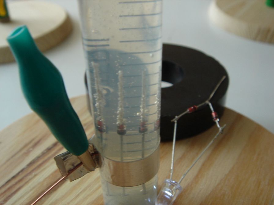

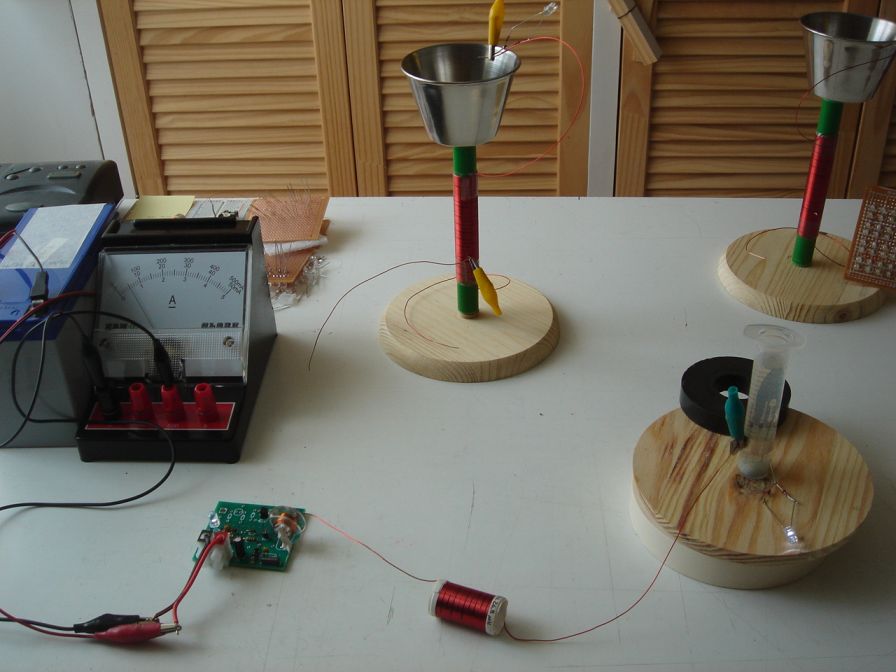

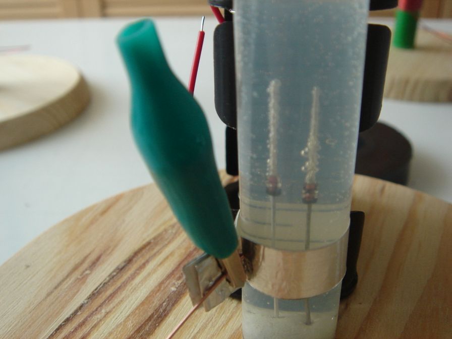

          electrolysis
          Dr. I have had no luck whit the LED adjustement trick jou suggested, but sure it's my fault, It seems that capacitance should play an important role and, I'm affraid my circuits are far from perfect. Everitime I touch anithing, it needs further adjustement, but it runs with one, two and four diodes.
          Adding diodes did not increased power requirements, although obtaines gas is too dependant of my setup, sometimes after a while gas increases, other times it decreases, it seems to be very affected from body proximity and wires position over the table.
          Sorry to have so little time, I just post to show the replication.

            @oldie
            The last part is indeed correct. It is not a function of current and is a function of frequency and bandwidth.
            Wel if you are doing it with the AV Plug shown close to the cell, that is not what I was talking about. Take your 48 LED board and connect to the end of L3. Tune for maximum brightness with minimal heating of the transistor. You should find two spots, one bright and low current thus low heat and another with brightness and much heating.
            Now when this point is found disconnect the LEDs and connect the cell.
            Some of the reasons for transistor heating, to high of a supply voltage, over 12V and depends on the load type, LED Inductive, Capacitive etc. Next is what all the old timers know by heart and I say it in my sleep, "Tuning". This is not like a transmitter final, you don't try to tune for a current dip only, you have to match (observe) output when tuning.
            Now the good reason for heating, you may actually be cohering and the additional energy is being dissipated in the transistor as heat. So how can you prove this? You must in this case use a calorimeter. You will be able to show that not only are you doing work at the output which can be calculated, but the amount of heat added to this work is at least 5X above the input.
            I think all that have been proficient replicators will admit and it is so true, you need to work with and get close to this type of circuit, then it like you are in total control and it all starts to make sense to you.

              Doctor,
              Again many thanks for your explanations.
              Yes, I used the 48 led panel, the litle AV plug is only to fine tune, as it gives me, (maybe I'm wrong) some idea of what the water is receiving.
              Concerning heat, I have not tried to measure, I just have my digital finger pain meter, but I nearly can assure 12v 50mA - 60mA is maybe too little power to drive a 500mA rated transistor so high. In fact, I tried the two transistor mod you suggested and got same results, maybe not so hot, but too much heat IMHO for so little current, don you agree?
              I have been driving the circuit up to 60 70 mA in his standard setup to single wire ligth the led panel and found the transistor only a little warmth, but with the wireless setup less current went in much, much more heat.
              Again thanks for your knowledge and time, I'm really amazed by the effects shown, and can assure will continue playing with it trying to understand what it's all about, that I'm sure can't be found in any book.
