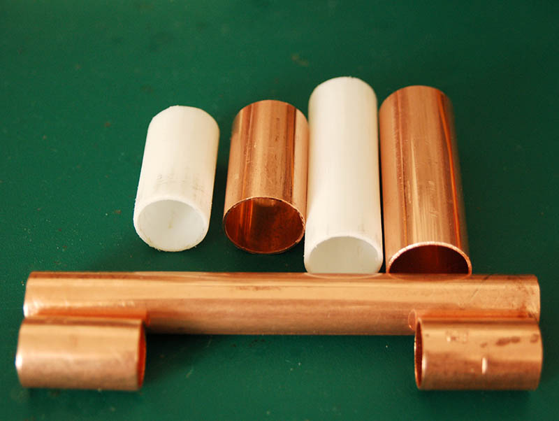

                            By the way, the space between the collector and ground cylinders can be changed, both slide over the center cylinder.

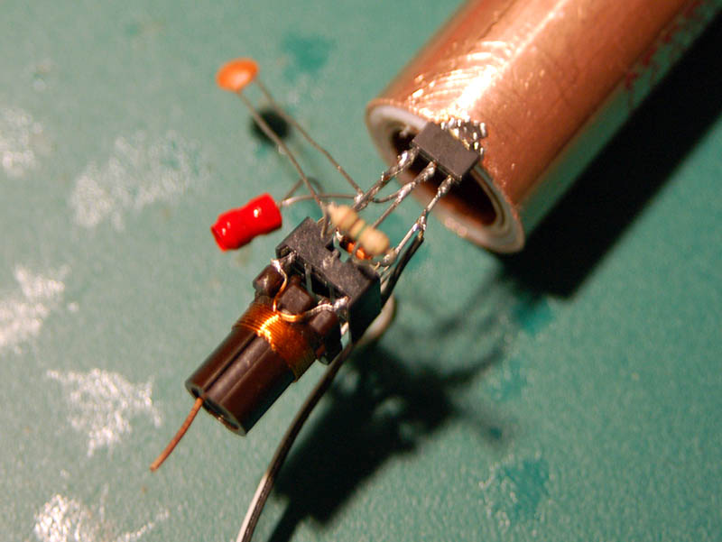

                              As promised here's the completed circuit replication. I have taken some creative liberty (Doc, please don't shoot me ) in not putting the circuit on the separate board as original demonstration, but directly wiring it on the gate's Collector cylinder.
                              I did this for two reasons: because I had an appropriate transistor (Fairchild PZTA06), and because I noticed that the transistor gets hot. By doing this I got two issues resolved, possible stray capacitance and cooling. The large pin at the top of the transistor is the Collector.
                              I left the wires of other components at their original length, but I could've shorten those as well. I did cheat on the L2 by using a pre-made choke instead of winding an air coil - I'll wind one tomorrow and replace.
                              There's no diode going from the power rail to the L2 though, as there wasn't one in the circuit on Dr.Stiffler's Spatial Gate page.

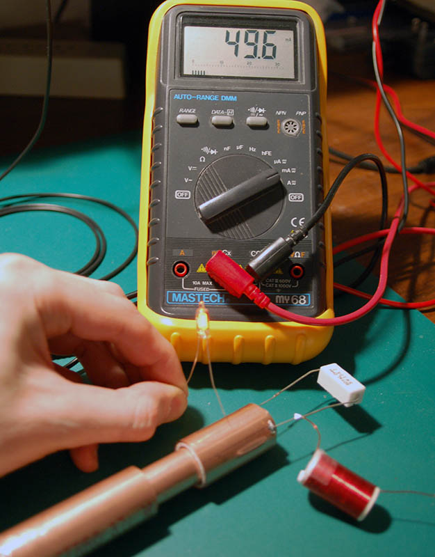

                              Included is the shot of my spectrum analyzer, set at 10MHz steps, with FM band at the far right, last two divisions, taken while I was holding the neon bulb to the Ground cylinder.
                              It also appears that my Spatial Gate produces AC, as indicated by the glow of both electrodes on the neon bulb.
                              The incandescent bulb is a 4W night lamp; the fluorescent is also 4W with a large 10K resistor for heat dissipation.
                              Current consumption, in mA, is shown on the DMM in each individual photo.

                                @Amigo, Much cleaner than what I threw together, just used some 1/2" and 3/4" piping and wrapped electrical tape around the smaller tube to get the spacing nice and tight.
