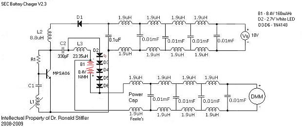

    I assume you do not wish to follow the battery charging as I proposed, so I am going to make a post to all that have a Exciter working and some can try.
    @All you need to understand batteries and charge and discharge rates for this. I make no claim here, it hold promise, yet needs work. It will charge the indicated battery in less than 20 minutes, but all is not what it seems.
    You just may solve a problem here if you look into it. But you must track charge and discharge energy over a controlled period and controlled rates.
    • Little B Charger
      @All
      If anyone tries the little battery charger, please; to start with do not take inventors license and start out with other parts or configurations. The White LED at 2.7V~ and the 1N4148's all in combination are here for a specific purpose. You must have a bit of background knowledge on the devil and batteries. Most important do not get to excited by 'Phantom Charge', this has tripped many a person up when working with batteries. Use a NiMH of 8.4V and less than 400mAHrs.
      Like I said, it is a start, maybe better than most. It needs a bit of study. I found that during real charge which I have pushed to 10C the battery does not get warm and so far does not seem to be degraded, this is why there may be a ray of hope here.
      I am not working on this at the present, it has been on the shelf for months and I do not plan a return in the near future, but I can help out if someone wants to look into it.

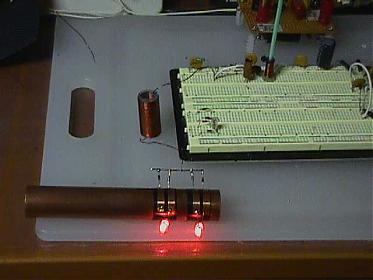

      • SGate Birth
        @All
        This is an old picture and is from a prototype where the SGate idea was in its formation stages. The load is two Neon's and the gate is the copper bands around the copper pipe. See the intensity of the neon's.
        This is just FYI

            @DrStiffler,
            Could you please clarify the filter at the top of the schematic because I have not been clear whether that's 0.01 MILI farads or MICRO farads (a typo using m instead of u).
            The 0.01 milifarads is kinda high for a non-polar capacitor, no?
            Also, when I connect the filter in between the power and the circuit, the current usage goes up by 50-100%. Why would that be happening when it's just ferrite beads and capacitors?
            Thanks.

              @amigo
              Just hate it when you do this to me, no respect for age? KIDDING....
              You are 100% correct, I have never used a milli-farad designation in my life and this is indeed microfarad. I always use the u (without the long tail from symbol font) as micro. Well I can at least assume you are paying attention, you would be amazed how much slips by that is never questioned.
              Thanks for pointing this out I will get it changed...
