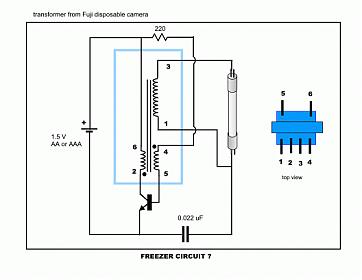

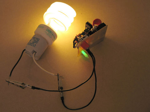

              Here is one that lights a cfl and two 90v neon bulbs

              Here is the circuit to the above photo

              These are not mine, I can't seem to get mine to work. I think I have my emitter-collector leads wrong. I am trying to use a B237 npn transistor T0126 package.
              The photos are from overunity.com in one of the biggest threads I've ever seen. (141 pages!! I'm only on page 30)

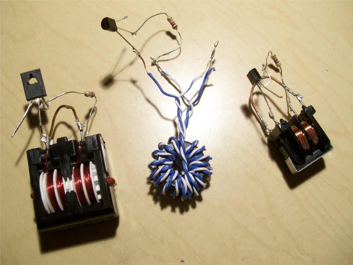

                    I can't get my joule thief to work. Spent 6 hours on it and 4 different coil, transistor and resistor arrangements and got nothing. Tried the 2n2222, 2n3904, and bd237 to126 transistors.
                    What's wrong with these?

                    I'm using cat5 cable for two of the coils
                    EDIT - I only have one LED I could find, so I am using jumpers for it instead of soldering all the time
                      [ATTACH]1908[/ATTACH]
                      I had watched this video which said you must use one wire from each pair, opposite wires
                      off the toroid and solder those together.
                      For example: If you used a blue and red wire then solder together the blue from one pair and the red from the other pair.
                      You have soldered together a pair of wires, not one wire from each pair.
                      That's All I know about it not working.

                        @ApEkV2
                        It looks like you have your coil wired wrong.
                        According to the circuit I posted anyway.
                        Instead of wiring the coil ends togeather, wire them togeather from the start of the coil wire with the end one.
                        So the white and the orange wire would be togeather but one from one end of the coil and the other from the other end of the coil.
                        I hope that helps if you look at my circuit you can see I have the + of one coil and the - of the other going to the positive of the source.

                          Fixed
                          That was the problem. Thanks for clearing that up for me Vortex and slayer007.
                          Here it is now the correct way. The sound they make are really cool.
                          I found the one circuit with the to126 package transistor worked the best out of the three.

                          That picture came out bad. But mainly the one in the middle with blue wire is easy to see the change. Thanks again.
