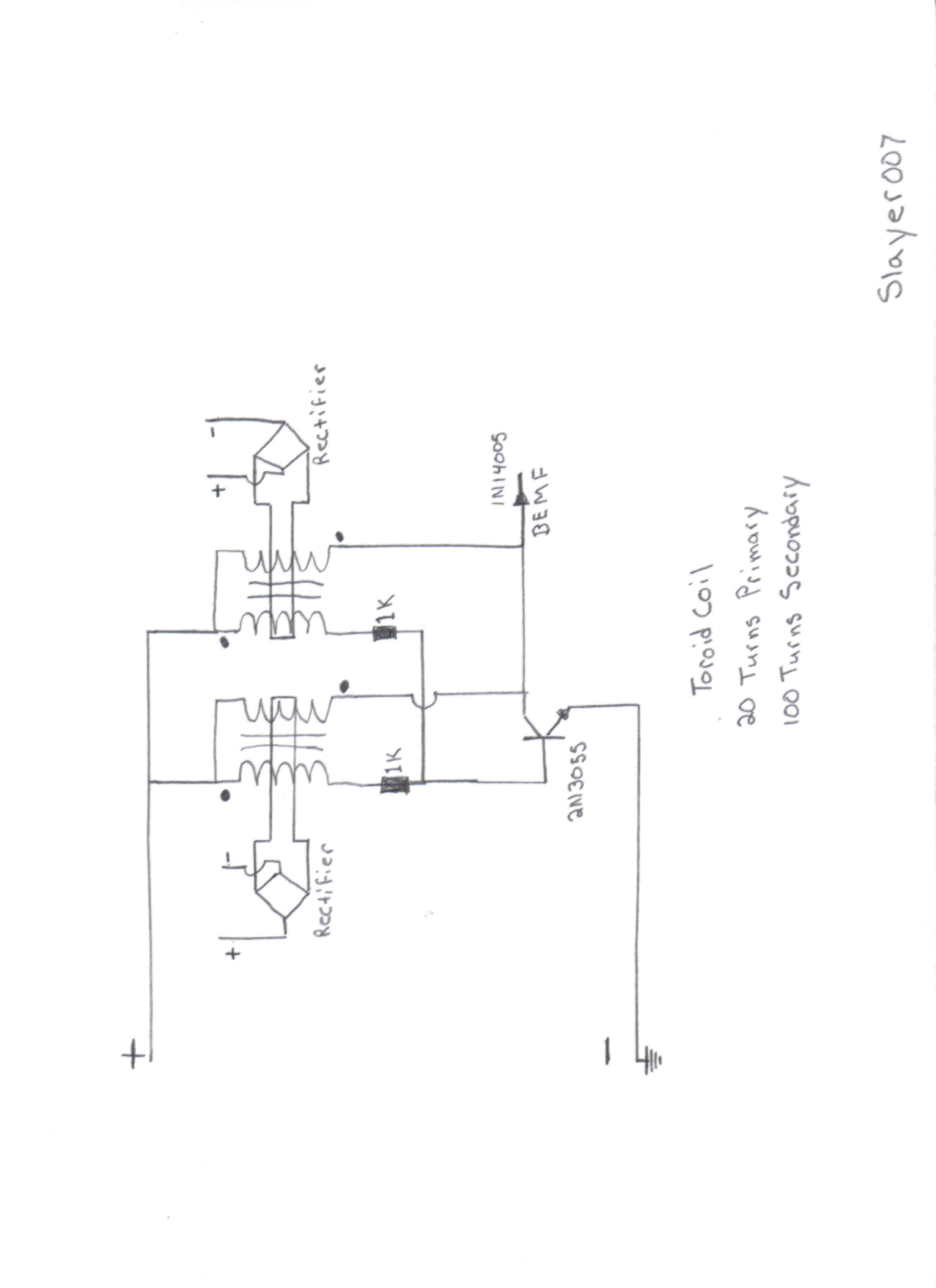

Heres a joule thief with two toroids going to the same transistor.
This way it seems to run twice as fast with both coils triggering the transistor base.
The joule thief is around 20 turns and the secondary coil is around 100 turns.
Right now I only have one torid with a secondary coil on it.
But adding the second one to the base still speeds it up and still gives you more power.
When I get another biger toroid I'll be doing it like in the circuit drawing.
Love your work slayer! Great videos, and cheers for the latest circuit. I'll try replicating this Big joule thief next. I've just got 2 little ones lighting bundles of LEDs at the moment, but I wanna go large....and you seem to have had a lot of success
Interesting setup, faster but more BEMF at the same time. You should get higher frequency too if you replace the resistor with 10K ohm, but BEMF may reduce.Originally posted by slayer007 View PostRight now I only have one torid with a secondary coil on it.
