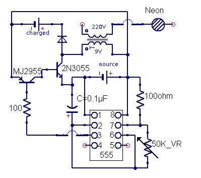

            • Here is what I use to get duty cycle from 50% to 1%, freq from 1Hz to 50Khz.
              replace the 100ohm resistor with variable resistor and use available calculator for duty cycle and frequency. I mention 50KHz max because I think that is max of what 3055 and 2955 can switch.
