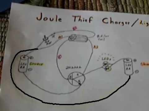

              • @lidmotor, I think by placing the charging battery like you currently do, it would charge up at both when the transistor is on and when the transistor is off. If you connect charging battery negative to source battery positive, the amp draw should reduce more. Your circuit would behave more like Bedini charger, it charge when the transistor is off.
                I think you would see more spike using this configuration.

                  • Charge battery return
                    @sucahyo-----I initially tried the charge battery return going to the source battery positive. If you look closely at my diagram you can see where I whited it out. Paul's circuit is the way I have it now-- going back to the emmiter. Both ways work. When I first set this up I even pulled the LED and used a 1N4007 diode to get this as close to a Bedini charging circuit as I could. Now after watching this JT run for such a long time, I'm wondering if a standard SSG circuit could be changed to this. Pull the 1N4007 and put in an LED.
