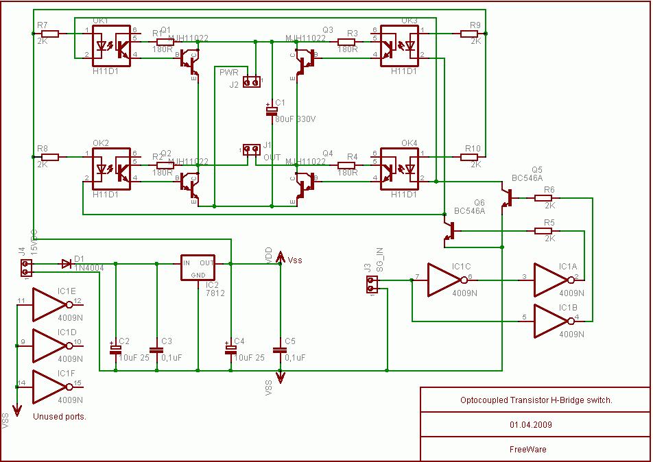

                  Hi .99,
                  I just looked through my stuff, topic at OU and could not find a real schematic other then the illustrative circuit. Also Groundloop is away on vacation so no luck there.
                  I've attached a circuit that was made by Groundloop some time later but it's not the same as the first illustrative one he made for me.
                  FYI, Gyula mentioned that the the CMOS version of the 555 family LMC555C or TLC555C is capable of going up to 3Mhz.
                  I also have 4 of IRFPG50 and 4 of 4N35 in my stock.
                  1000vdc handling capability is not necessary just a wish
                  Thanks for your help
                  Luc

                  • Thanks Luc,
                    It's not a problem re. the schematic.
                    I've already got a good notion of where I'm heading with my design.
                    It may or may not use the high speed 555, but it will give you the duty cycle and frequency range you're after. At least I'm hopeful of the frequency, that will depend on the MOSFET and a couple other things.
                    As TK has shown, the IRFPG50 is a slow MOSFET, so I may not use it. I will certainly try it if you wish. It's probably more rare and more expensive than the good old IRF820 or IRF840's though. One advantage of the G50, is it's a 1000V FET, so I'll definitely try it.
                    Doubtful I'll need opto-isolation for my design, but I will keep it in mind.
                    So far so good
                    .99
                    PS. You realize that 1000VDC input would likely result in 10kV or more resonant voltage right? The highest voltage MOSFET out there is about 1500V, so it would blow quite readily with 10kV across it.

                      Thanks .99,
                      I've got a bag full of IRF840's so if they work better then the PG50's that is fine with me and I think they are rated at 600v
                      Is there not a way we can prevent (isolate) the Resonating coil's voltage rise to come back and fry the mosfet? Even considering coil construction!
                      Thanks for your help.
                      Luc
