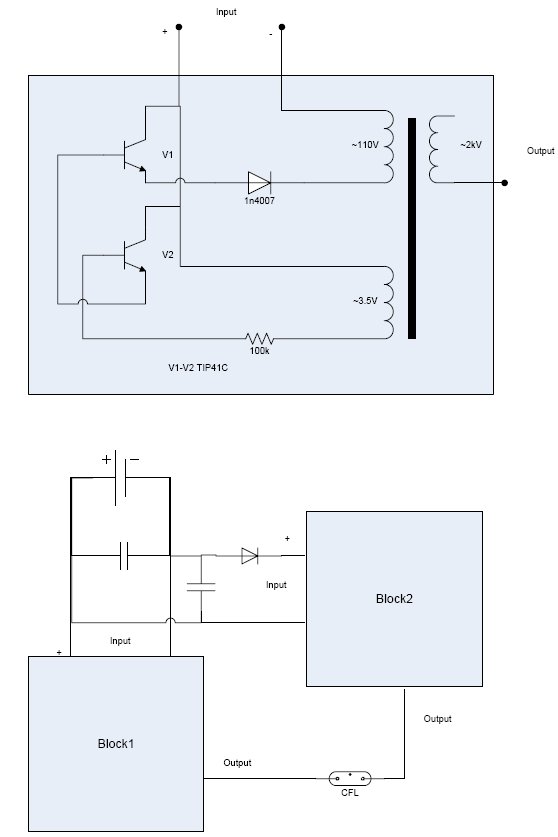

    Here is my schema. I was using microwave transformer. Transistors are not heating up. And CFL is bright.
    Good to see someone esle using something besides an ignition coil. Nice feed back arrangement.
    I found that the lower frequencies provided more light with the mot, but with the toroidal higher frequencies gave me more light.
