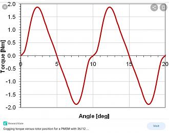

                      By "lock" you mean unable to rotate with applied shaft torque, right? The forces involved with this condition are in what I referred to as tangential direction. This tangential force develops when the magnet is displaced an infinitesimal distance from core alignment (TDC). This tangential force times the radius of the magnet circle is the amount of torque which must be applied to the shaft to cause rotation.

                          Because cogging is the torque caused by the tangential force, magnet to core.

                          • Just look at the graph instead of speculating forever and a day! Click image for larger version  Name:	Screenshot_20210308-234407_Chrome~2.jpg Views:	0 Size:	110.3 KB ID:	503942
