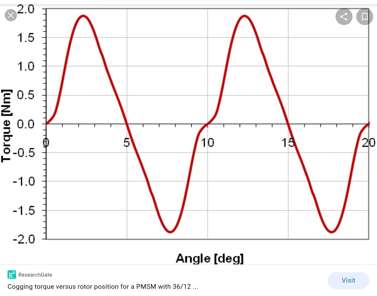

    Just look at the graph instead of speculating forever and a day! Click image for larger version  Name:	Screenshot_20210308-234407_Chrome~2.jpg Views:	0 Size:	110.3 KB ID:	503942

    Your ability to define words I can look up in an online dictionary is surpassed only by your lack of understanding of how things work in the real world.
    Again, if the axial magnetic attraction of rotor magnet to core has been neutralized by “forces” as you claim, why does cogging exist.
    Because cogging is the torque caused by the tangential force, magnet to core.
    edit: look it up.
