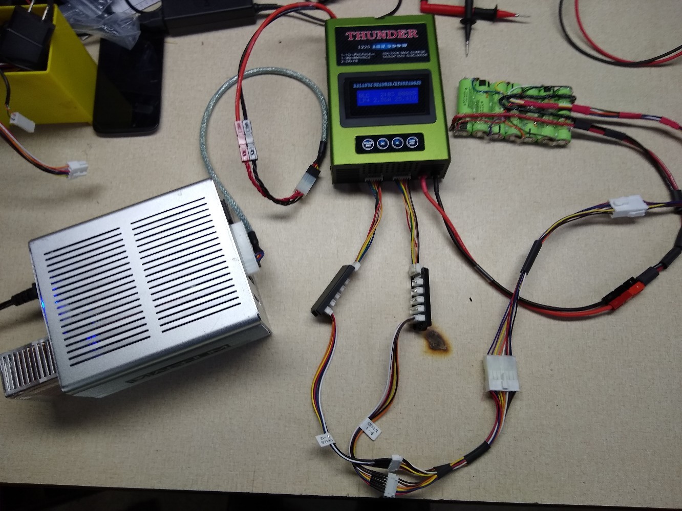

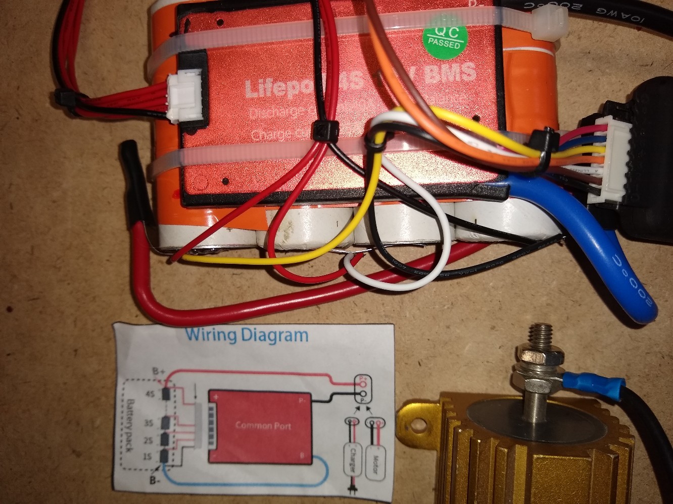

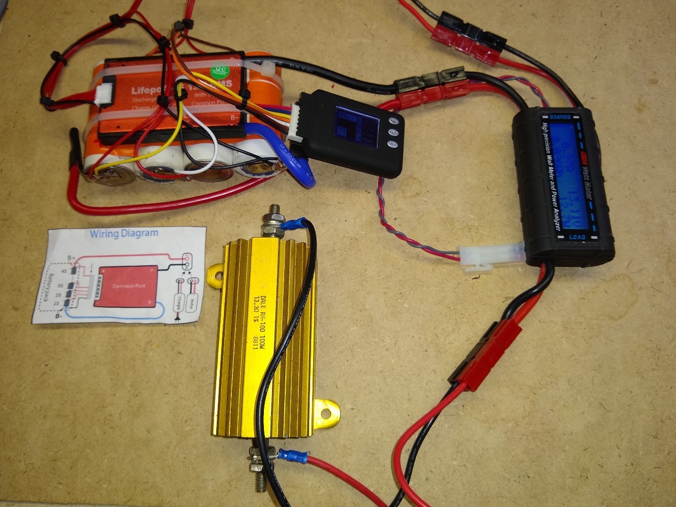

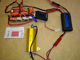

    And a couple photos:
    ​​ Click image for larger version Name:	IMG_20200808_175554350.jpg Views:	0 Size:	338.4 KB ID:	499992
    Click image for larger version Name:	IMG_20200808_175527203.jpg Views:	0 Size:	308.8 KB ID:	499993

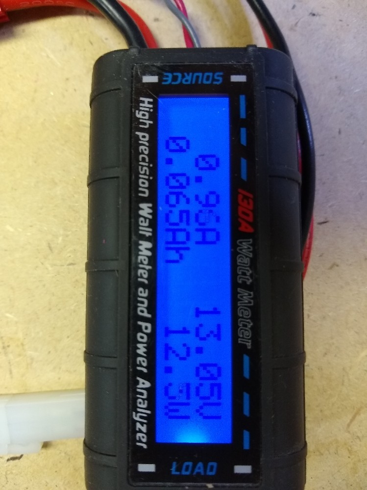

    Just a short 'see if it works' test. Discharge at ~1A.
    Click image for larger version Name:	IMG_20200808_175747093.jpg Views:	0 Size:	129.8 KB ID:	499994

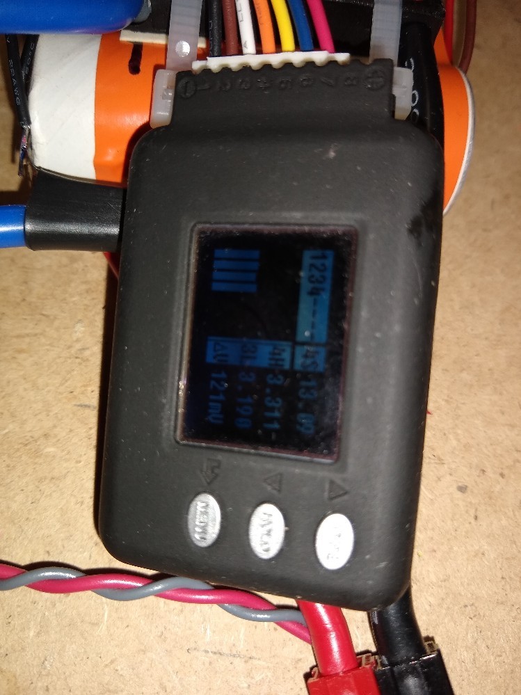

    Next, a cell logger. It will keep track of the 4 individual cell voltages during the tests.
    Click image for larger version Name:	IMG_20200808_175636586.jpg Views:	0 Size:	153.0 KB ID:	499995
    If tests go ok I'll heat shrink the 4 cells and BMS together in a nice little 2.3Ah 12V battery.
    Link to BMS if you're interested:
    https://www.electriccarpartscompany....agement-System

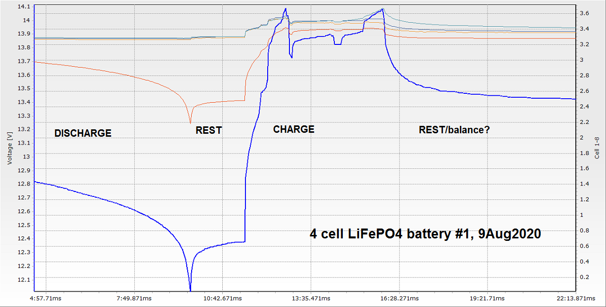

      This is a download graph from the cellLogger. Blue trace is battery V and 4 other traces are individual cells. Cell #3 was under charged to start with. BMS did open circuit (turn off the battery output) when lowest cell (#3) hit 2.5V just like it supposed to. And as I monkeyed around with charge current from a power supply, it indeed did open circuit (prevents overcharge of any cell) on cue. However when left disconnected overnight, the BMS did little if anything to balance the 4 cells. So I've been manually equalizing cells today. Unless cells are equal in voltage and state of charge I won't get full capacity from battery.

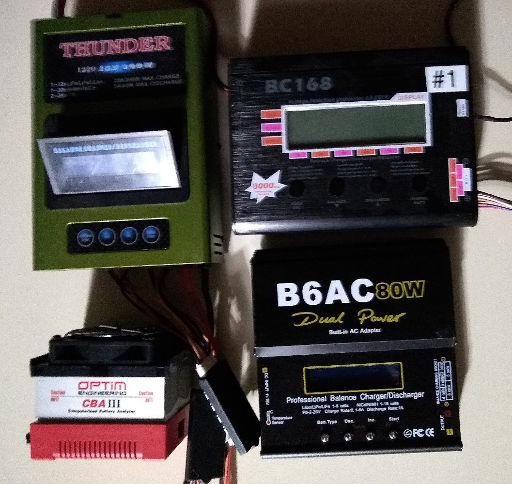

      I have a few different cell/battery analyzers from the hobby industry for smaller capacities. I'll list or take photo of those once I get this thing balanced and on test. A lot of past experience was with medium capacity stuff like 10 to 100 Ah. Occasionally barrowed big high voltage/high ampere rig from nearby university, but most was done on homebuilt analyzers, meaning discharge and charge apparatus and data collection instruments.
      • Altrez,
        Here's my collection of cell/battery analyzers.
ID:	500006 It's been a while since I've used a couple of them. I think I'll need to try one of these on this new battery. Might just be that cell #3 is bad from the start. Ignored or forgot my own rule.... Test components prior to assembly.
          Hi Altrez,
