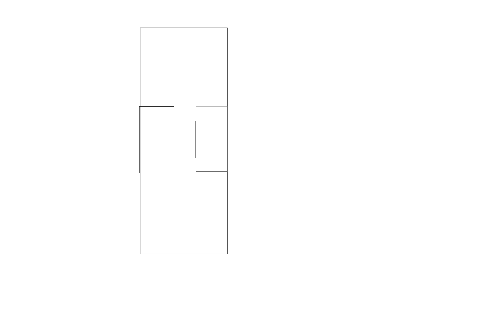

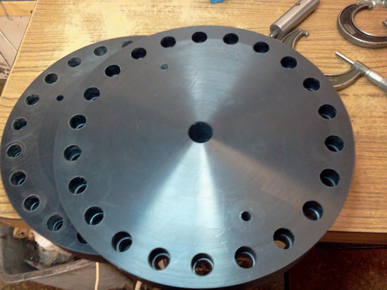

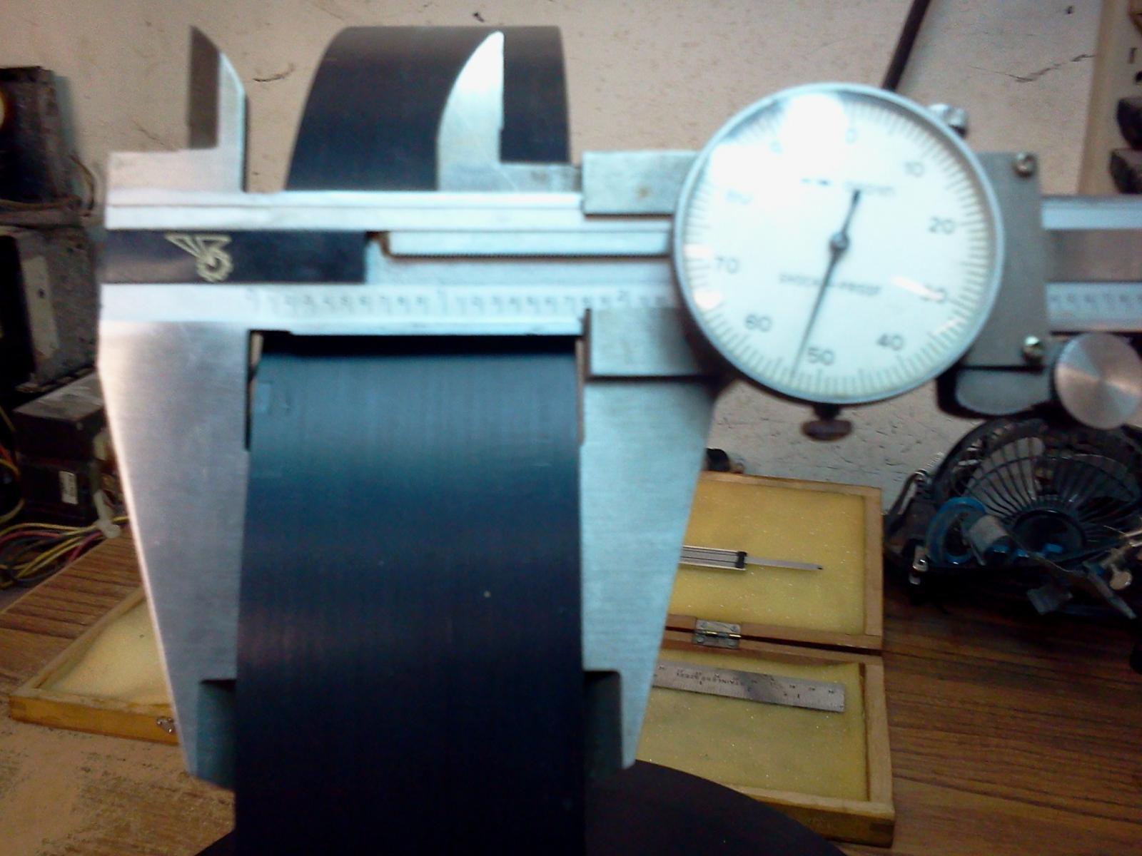

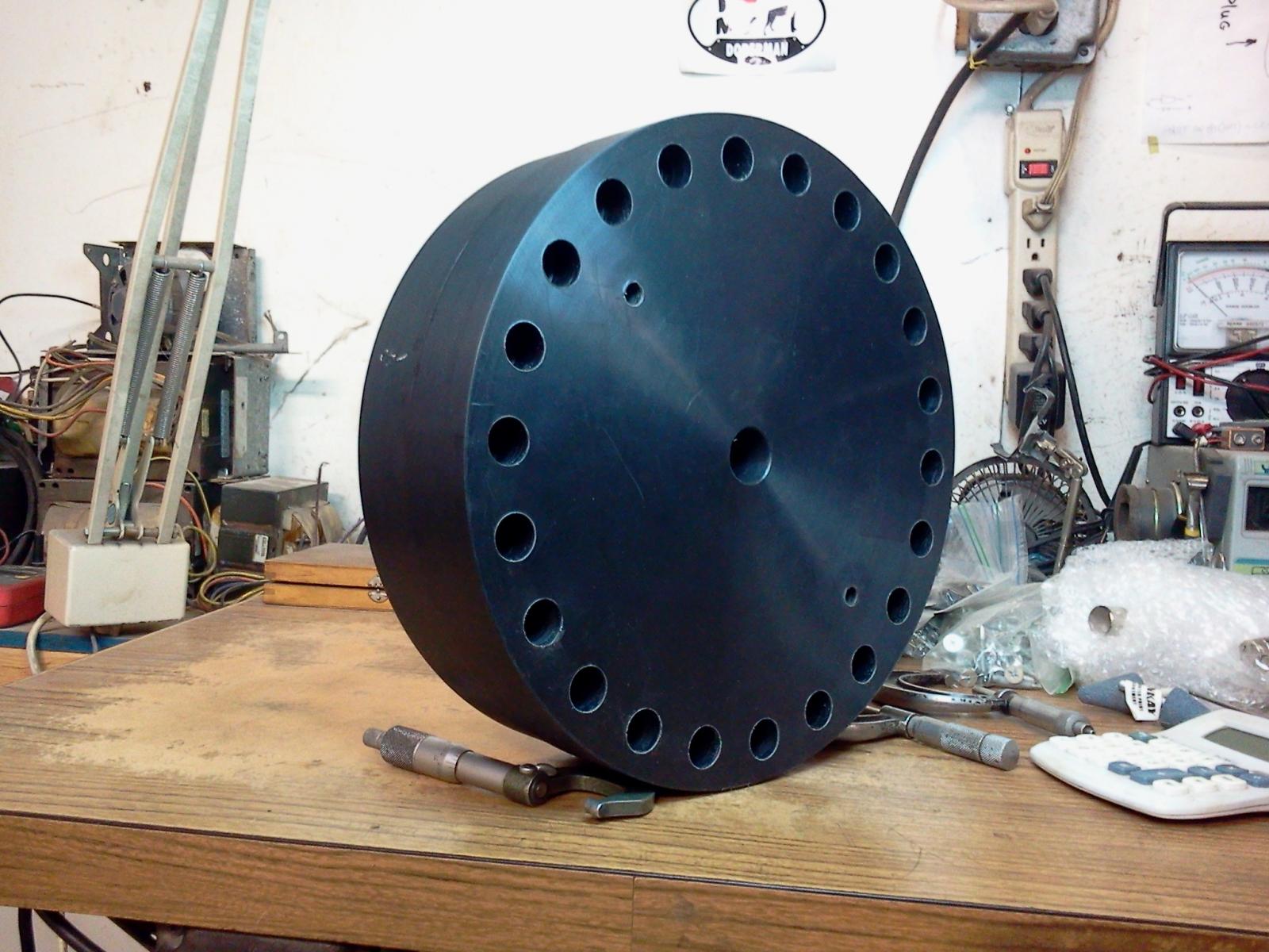

In the rotor there is a 3/4" x 3/4 hole for magnets on each side of a 1/2" x 1/4" thick hole. This allows a 1/2" diameter magnet that is 1/4 inch thick to be put into the center hole, and 3/4" x 3/4" magnets to be pressed in on each side of it until they make contact with it. All three magnets will be touching each other, and none of them will want to come out of that rotor once they are in. It's nice that I now have OTHER people working on this and don't have to try and do everything myself. I'm. still very busy remodeling. New crap keeps turning up that I have to deal with. SO frustrating. But this motor project is moving along without me. Very cool.
