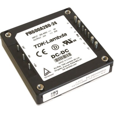

High voltage DC input and 24 volt output up to 25 amps. I have one on order.
Motor Generators
Never saw that one. Is that all you need? Or does it require an external circuit to operate the brick? Must be mounted on a very large heat sink, spensive little cridder. Sweet, the nice thing about this high priced block is that you can hang a pot on the output and vary it however it is unknown as a dc motor controller.Originally posted by Turion View Posthttps://www.alliedelec.com/product/t...8024/71938445/

The thing about it is these coil packs produce 325v under load (leaving a few volt ceiling) at 300watts so any 280v input unit will fry. A max rating for the input device should be 400v.Originally posted by Turion View Posthttps://www.alliedelec.com/product/t...8024/71938445/

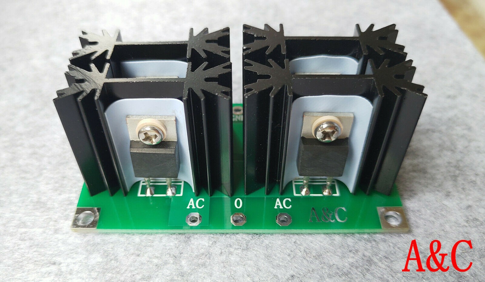

Also to whom this may concern, an example of an ULTRAFAST bridge rectifier board. Standard 60hz rectifiers are not Ultrafast. 60hz diodes are rated in ms miliseconds response time. This is very slow, where ultrafast is a few ns nanoseconds response time used in audio work ranging from 500hz to 20khz
Remember that China ratings are often 5x higher as a max rating. This bridge is very small and would handle 3 amps all day without heating.
https://www.ebay.com/itm/64A-600V-Fe...4AAOSwajFe2NG9

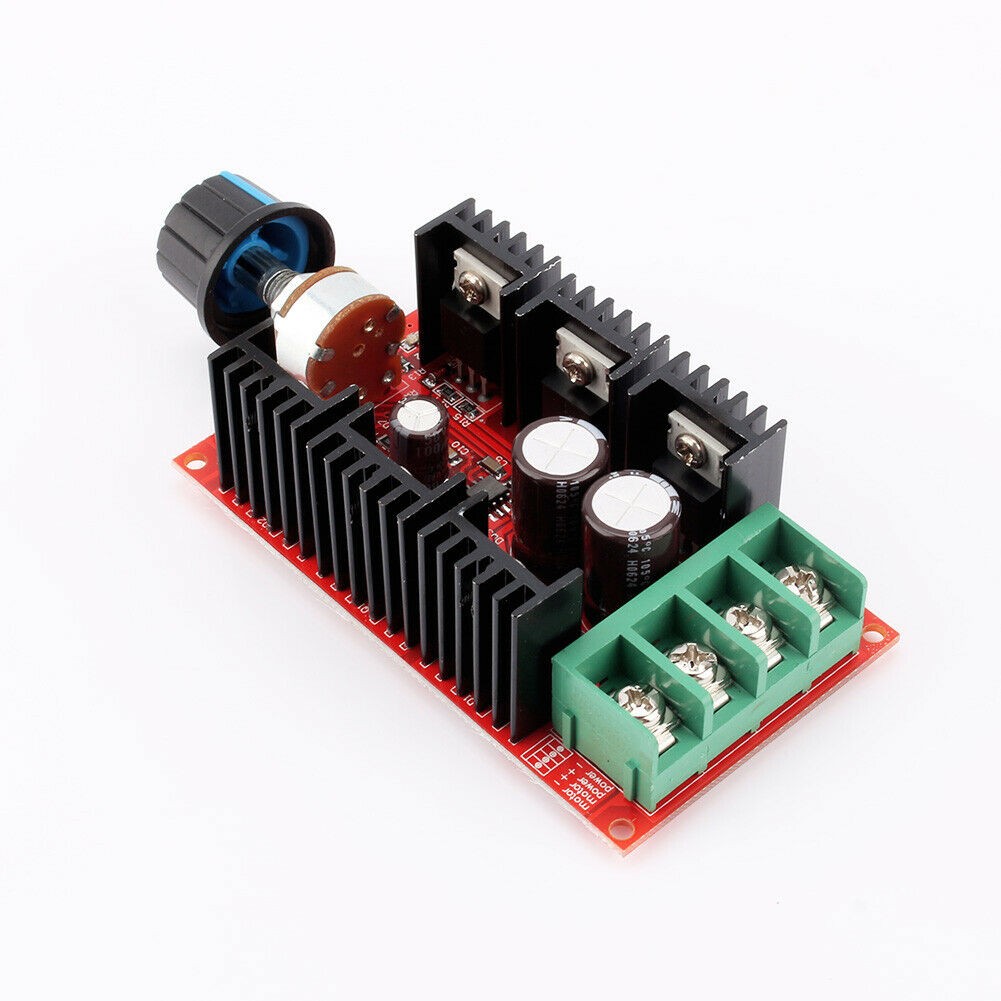

What if he need 3050 rpm's not 2800 Rpm's?? Better be able to go up to 3300 rpm and back down from there. Only way is do like the ebike guys do, fed a little over 36v, say 40vdc so best to buy the big controller on ebay that allows you to use 30-48vdc. But like you say it was designed for 2800 -2700 rpm's? Or did your old rigs really get read accurately? Some of those laser probes show a wild swing. This one let's you go from 10v-50vdc so make sure you have the voltage for these tests. A 48vdc switching supply is cheap.Originally posted by Turion View PostMet with Greyland.............. will be converting the machine back to a DC motor and adding a motor controller so they can see if reducing the RPM will affect the "neutral" condition.
https://www.ebay.com/itm/MAX-10-50VD...Cclp%3A2334524

This controller is cheaper

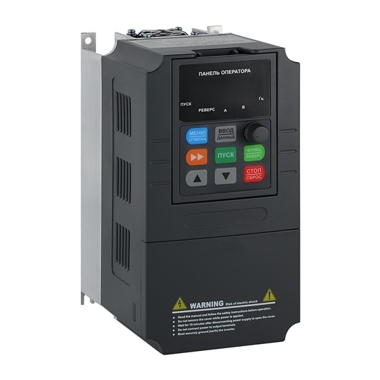

You did say the new unit was producing more power than the old one with the greater RPM. Most people do not have a VFD to control their single phase induction motor which is a requirement to raise and lower speeds. Such a VFD or MPPT would be pricey compared to DC controllers and no more efficient. This discussion is for the looped side. You want the looped function apart from the main output so no need using induction motor drives. KISS.
Next we move to the 5 coil packs that will be devoted to free power. You can get cheap 380v input VFD supplies that output 110v or 220v. 50hz or 60hz. Use the fast bridge, feed the onboard cap bank that is made for the box, do not add caps.
Look for the B+ feed connection. VFD's often let you feed the cap bank directly bypassing the onboard bridge which is the first stage.
BTW
As a for instance.
10 Solar panels connected in series can be fed into the 450vdc ports. Using high voltage on the input at a lower amperage is a cost effective conversion.Last edited by BroMikey; 12-19-2020, 06:18 AM.
7" X 9.5" box called VFD single phase input 200vac-255vac
Output single phase 0-220vac adjustable, Frequency adjustable
weight 8 lbs. This is the proper drive to supply current to an average household. You need suppression connections to ground and other surge reactors as they are called as part of a product for-sale. You will learn. Your unit will be well worth $4000 upon completion even tho it will only provide a continuous 1000 watts output.
This would mean a great deal to those who use RV's to live in worldwide. With 1000watts continuous the operator could run the blower on their gas boiler furnace/pump and all the lights/tv in a whisper quiet format compared to a gas engine. They could save $65 per month that normally they would have to give the power company. Where there are no power lines this unit would become invaluable. RV owners will gobble them up. Foot in the door filthy rich, non stop production.
https://www.ato.com/3hp-vfd-single-phase-input-output
