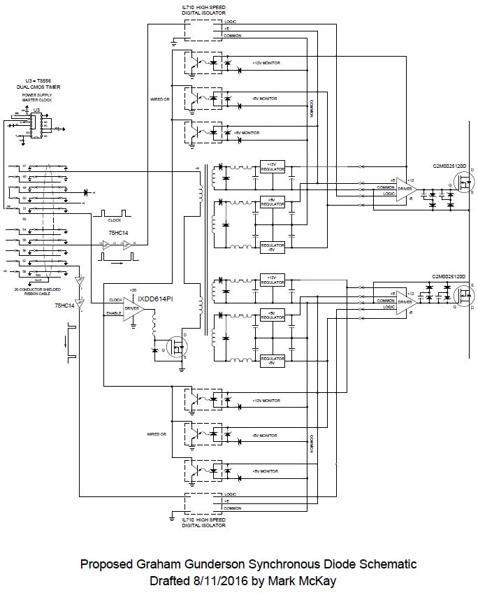

            Thanks for this circuit Mark. I do have a question.
            It's my understanding that the SiC MOSFETs require a 20v/-5 volt gate drive. How is that accomplished in the schematic given?
            Also, I may have missed it, but what function does the toroid located at the bottom serve?
            Thanks,
            Alan
              Thanks,
              Alan

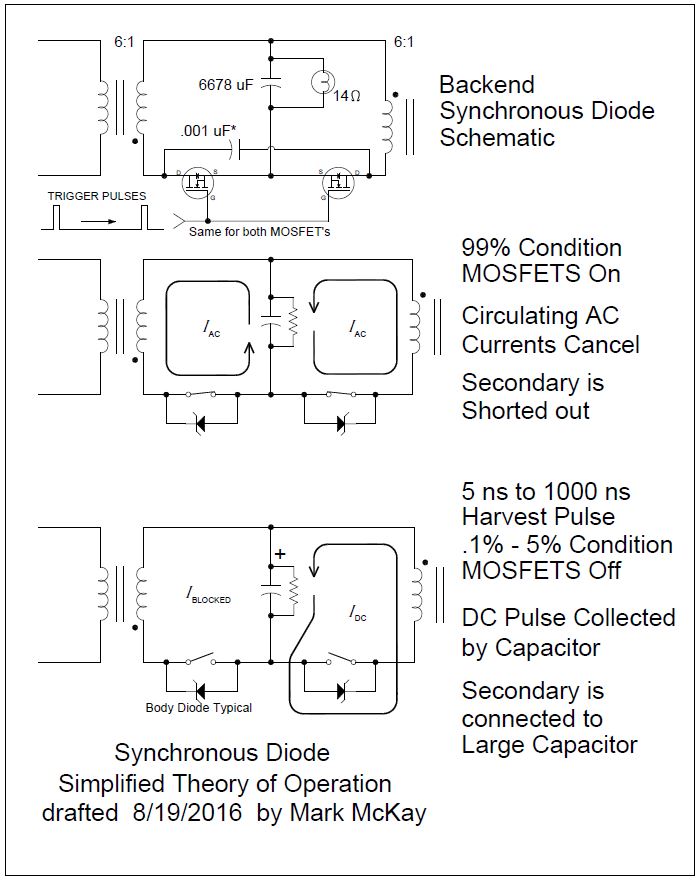

              Dear Alan,
              Graham actually has a dual channel isolated DC to DC switch mode power supply on the Synchronous diode circuit board, that is the purpose of the ferrite core in the center of the board. There are six windings on that ring. I believe that two of them are primaries and the rest are secondary's. Graham told me that the six photo isolators are Zener controlled and provide regulation feedback to gate the master oscillator. I believe that the TS556 timer, way back on the logic board, is the actual Power supply master clock. His circuit generates three voltages +12, +5, and -5 Volts.
              Keep in mind that there are a lot of components on the back side of that board that are not shown in the photos we have.
              My next drafting project is going to be a block diagram of what I think is on that board. That should help explain what is going on.
              Really there are several ways to do this. As far as I understand it the control of the synchronous diode is simple. Both FETS are closed for 99% of the time. then they are opened between 5 and 1000 nS at a precise time in the systems timing, one pulse per cycle of operation.
              While the FETS are closed there are two current loops feeding the big storage capacitor. the opposing currents cancel each other out so the net charge on the capacitor is whatever has been rectified into it in that brief moment.
              Spokane1

                PC
                Very interesting. I will wait to see what your block diagram looks like.
                I am tempted to use my basic IRF mosfets to do a more simple replication just to play with it.
                I also don't know what cores would be ideal but I have some smaller ones to play around with.
                Your work is very important to making it viable though because SiC MOSFETs and Litz wire are going to be necessary.
                  Dear Alan,
                  You are correct on the drive voltage for SiC devices. Graham specifically used +12 and +10 Volts probably for example rather than actual values. Everyone is going to have to adjust their power supplies to the devices they can afford.
                  Attached is my take of the Synchronous Diode Schematic. I'm sure improvements will be needed.

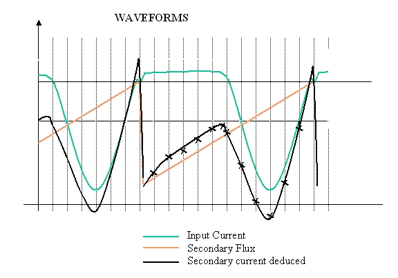

                        Forward from Smudge [Cyril Smith]
                        Quote
                        From GG's demonstration of a sawtooth flux waveform I have taken the primary current waveform then deduced the secondary current needed to create that sawtooth, assuming normal transformer action where the flux comes from the difference between pri and sec ampere turns. Done crudely from my sketched waveforms. And I get a secondary current very much like that shown by GG. So I deduce that there is no significant flux leakage and my original estimate of the primary flux waveshape is wrong.
                        Smudge

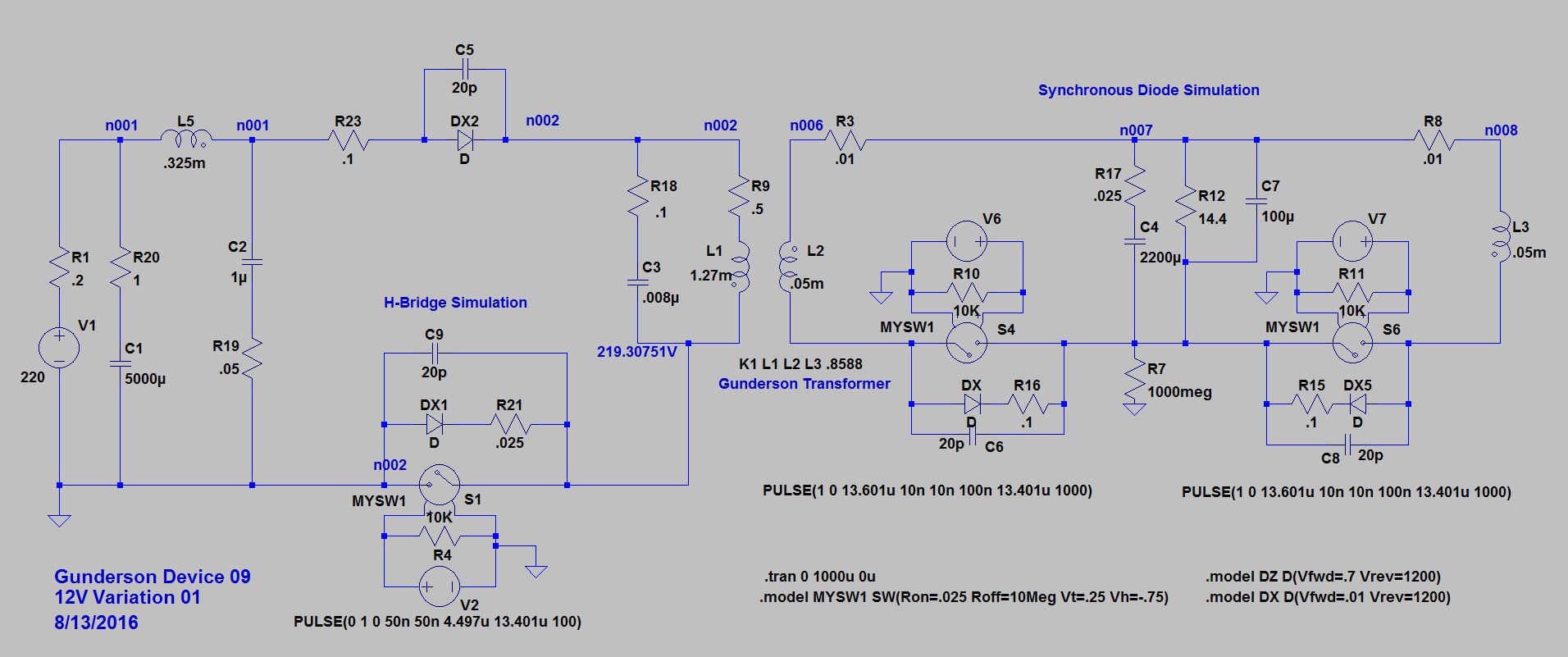

                          Gentlemen,
                          Folks disregard this drawing - it is missing some components - I shall repost an updated version below.
                          In my simulations of the H-Bridge circuit I have found that two of the MOSFETS are not active therefore making them unneeded. Upon further examination I have found that the entire H-Bridge can be replaced with one switch and a diode. The input to the primary of the Gunderson Transformer is the same in that it produces the same voltage and current wave forms with far fewer components.
                          k4zep made additional simplifications by proposing that the switching elements be placed on the low side of the circuit to better reference driver connections. This circuit variation also simulates the same as a full four element H-Bridge.
                          Graham said 7/18/2016 that he was planning to redo his H-Bridge with a two switch design. He also said that providing schematics to his demonstration device would be pointless since he was planning to re-do all the circuits. Both statements seem to be correct.
                          Anyway, here is the proposed simplified circuit. The elimination of three switching elements should reduce the gate leakage issue by 50%.
                          Does anyone see any issues with this design and why it might not work as good as a full H-Bridge in this application?
                          Oops the polarity on the 220 VDC power supply is backwards.
                          Spokane1

                            Gentlemen,
                            Here is my take on the operation of the Synchronous Diode.
                            Comments Welcomed!
                            Spokane1

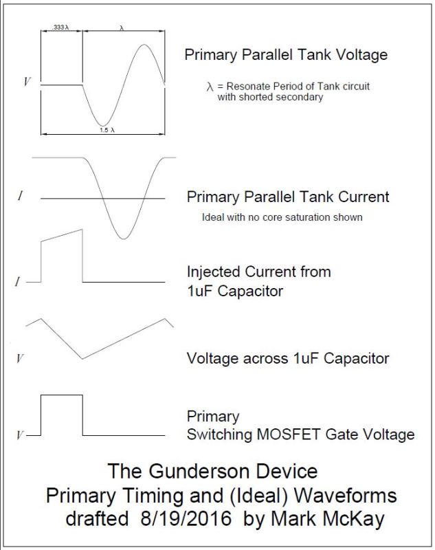

                              Dear All,
                              Here is the updated schematic, Lt Spice schematic and a timing chart for the primary circuit for your use and pleasure.
                              Spokane1

                                12 Volt Operation
                                Dear All,
                                This weekends work showed a little promise. I was able to get the junk box mockup circuit to lock into the proper timing sequence to display the discontinuous sine wave. I just have the primary circuit operational. This evening I shall add the synchronous diode circuit and start to get a look at the backend operation. For what its worth this circuit shows:
                                1. This circuit will function at 12 VDC (using the single switch approach)
                                2. Operation can take place as low as 3.2 kHz
                                3. A classical laminated iron core will support the novel oscillation pattern.
                                None of this means that we are in the OU window of operation, but it is nice to see some hardware implementation of the circuit under discussion. Using the component parameters I have in the actual circuit the simulation shows that I might be able to harvest up 6.5 Watts at a COP of .863. I'm sure the real world performance will be far less than this.
                                The advantage of the 12 V approach is that all the excitation energy comes from one source. All the gate losses, skew losses, and magnetic probe interference issues can be evaluated. If this circuit can perform as a self runner then this is the direction to go.
                                The simulation also shows that the circuit performance improves if I were to use a smaller charging inductance choke. The junk box device (from a salvaged X-Ray transformer) has a 1 KHz inductance of 11.5 mH. The simulation shows that I need a 2 mH unit there. Grahams circuit apparently used a .0324 mH custom device.
                                If any one is interested in a schematic for this temporary evaluation circuit let me know. I'm sure there will be several variations employed as the circuit technique improves.
