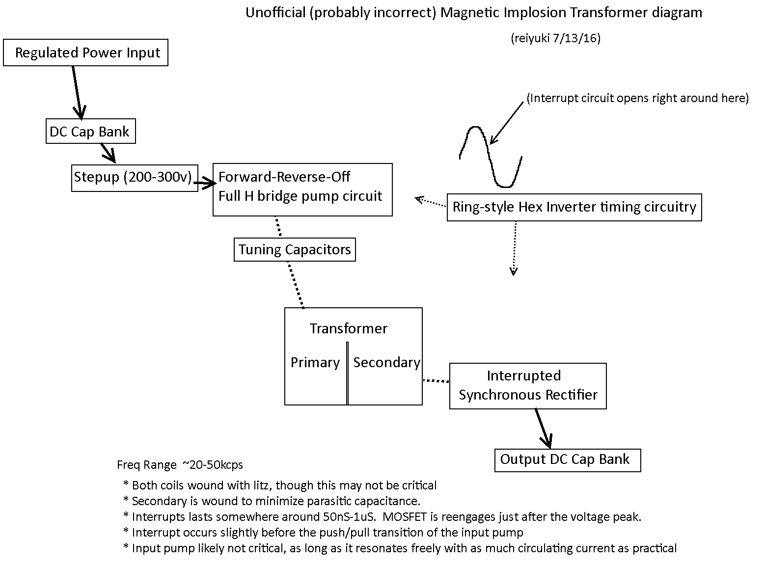

He showed all the various wave forms on the presentation screen and offered his best understanding as to how it worked (but no idea as to why). The source appears to be a 12.7 A-hr lead-acid gel battery that feeds an "H bridge" chopper that then goes to a step up transformer. The peak excitation voltage is around 800 volts. The input is a single sine wave followed by 1/3 cycle of zero voltage and then repeats. This is the input to his custom conversion transformer which is composed of two large "C" Ferrite core pieces. They don't have the same properties. One has a high permittivity and the other has a lower value. The cores are beefed up with about 20 Manganese Ferrite PM's (2" x 3" x 0.5". The primary is wound on the upper core while the secondary is on the bottom. The secondary is composed of four parallel turns of about #10 AWG Litz wire in three loops. (The good stuff). The output is rectified with a synchronous diode made of Si-C FETS and a custom snubbing driving network composed of zenor diodes so that no gate resistor was used.
There is also a timing network involved to coordinate the various cycles, but no microprocessor. The output is then filtered with a large capacitor network and then drives the automotive lamp.

. If you're doing a 100% replication, the most expensive parts will be the actual circuitry (there is a lot of it), while the hardest-to-find parts will be those specific ferrites. ~1-2k sounds about right, along with several months of construction.
The answer to that is actually pretty important, because it would tell us what is happening to the flux inside the circuit. If we get spikes back to the input, we'll know there is flux being counter-induced in the primary. If we only get spikes on the HV side, we'll know there is a one-way action and that the output portion is the critical part.
