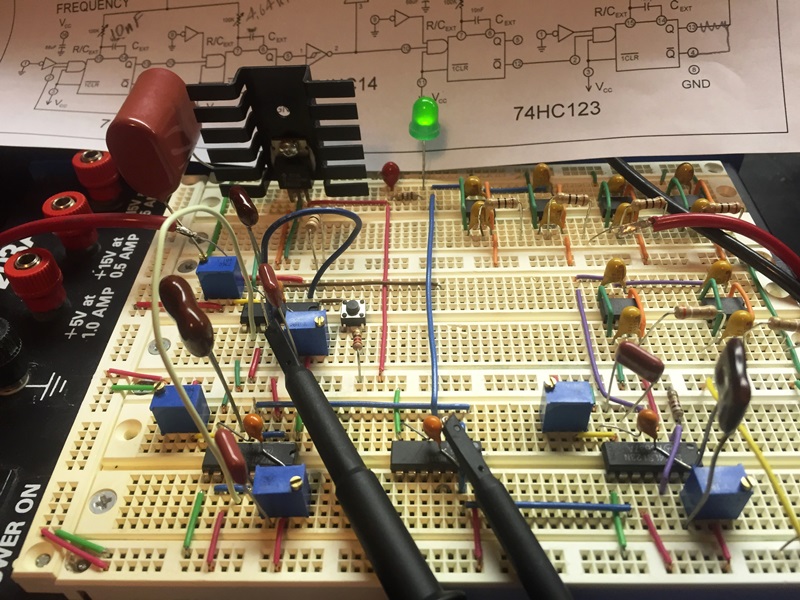

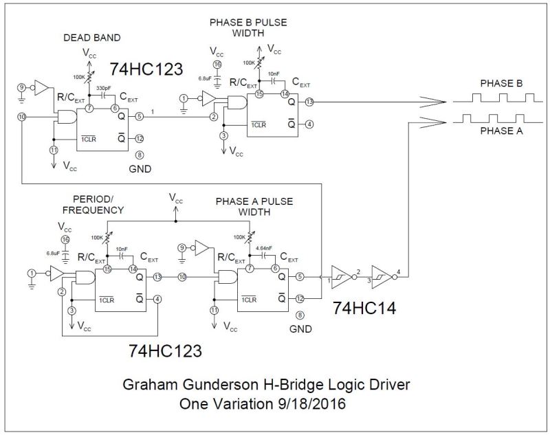

Dear All,

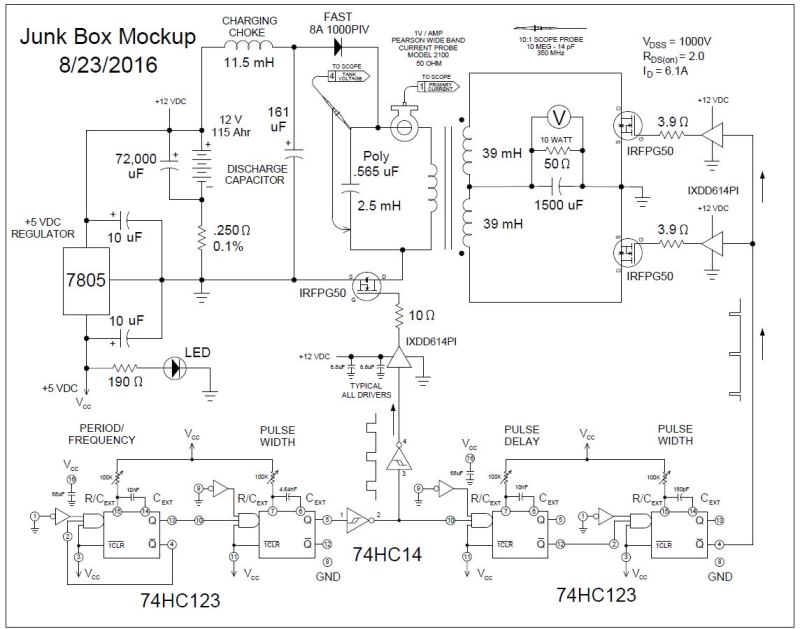

Here is the schematic for the circuit under consideration. Note this is a simplified approach and is not as advanced as the original Gunderson circuit, but it is a lot cheaper.
