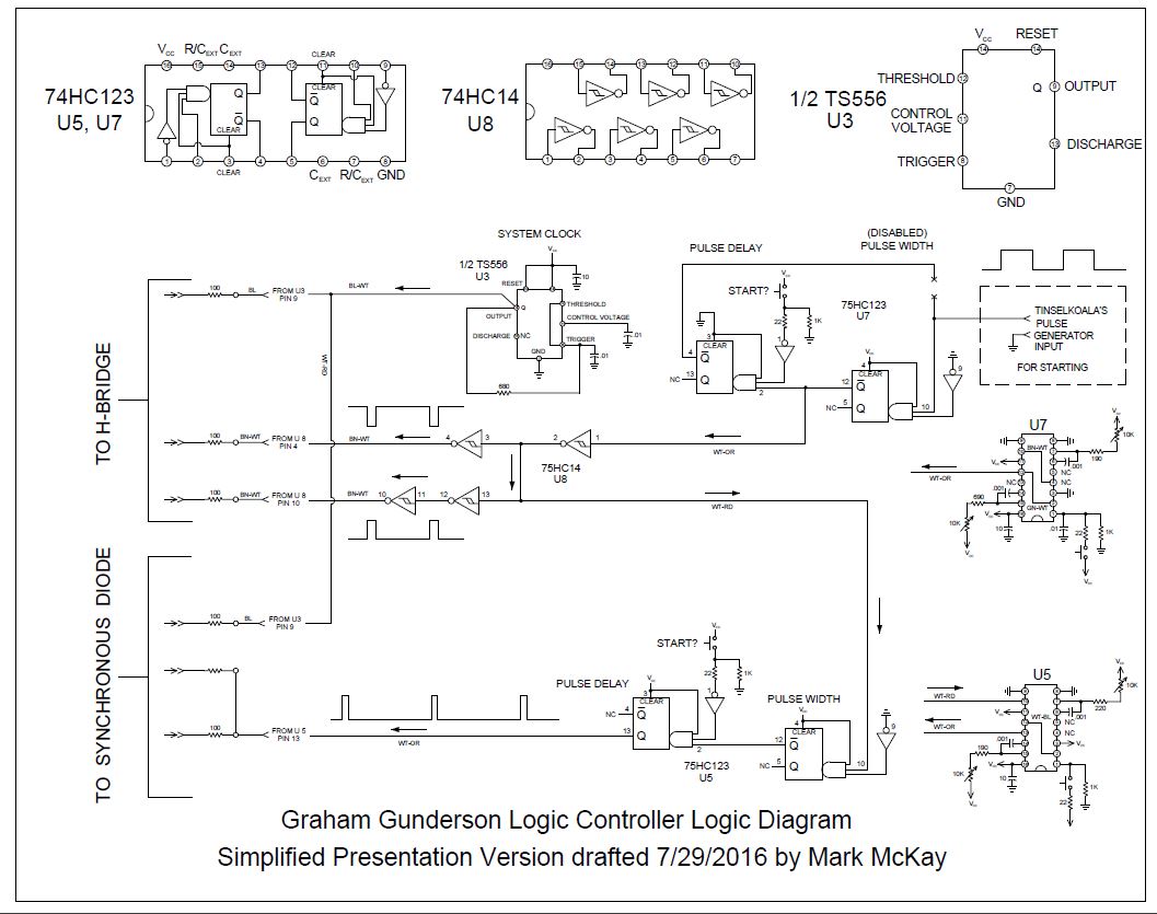

                • #38
                  Logic Diagram
                  Dear Builders,
                  This is the system logic controller diagram to date.
                  Enjoy!
                  Spokane1

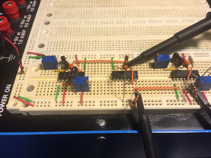

                  • #39
                    Logic Circuit
                    Dear All,
                    Here is another implementation (Bare Bones) of a Logic controller for the Gunderson Device. This one uses 100K trim pots and 1nF timing capacitors. It also gives a wide range of control over the timing parameters. I used 74LS123 and a 7414 (obsolete). The newer HC CMOS versions should give even better performance and can run at a higher voltage. This arrangement appears to have no starting problems.
                    What is missing are the trim pot saver resistors (typically 200 Ohm), more bypass capacitors, the push button switches that Graham used (for testing?) and the extra wiring shields around the ends of the IC's (see Graham's photo to see how this was done). I don't know if any of this extra stuff is needed since the fast transition times are controlled by the Power MOSFET drivers.
                    It appears to me that all of the timing parameters in this sub-circuit are manually controlled. I thought there would be some logic derived control signals, but apparently not.
                    Many thanks to TinselKoala and k4zep for the development of this circuit.
                    Up next. The development of an LTSpice VII simulation to see how those timing pulses control the H-Bridge to generate that discontinuous 2/3's sine wave excitation input.
                    Spokane1
                    • #40
                      Did you found what is the purpose of all this electronics ? What it does to the signal going to H-Bridge and what is the final power signal results ?
