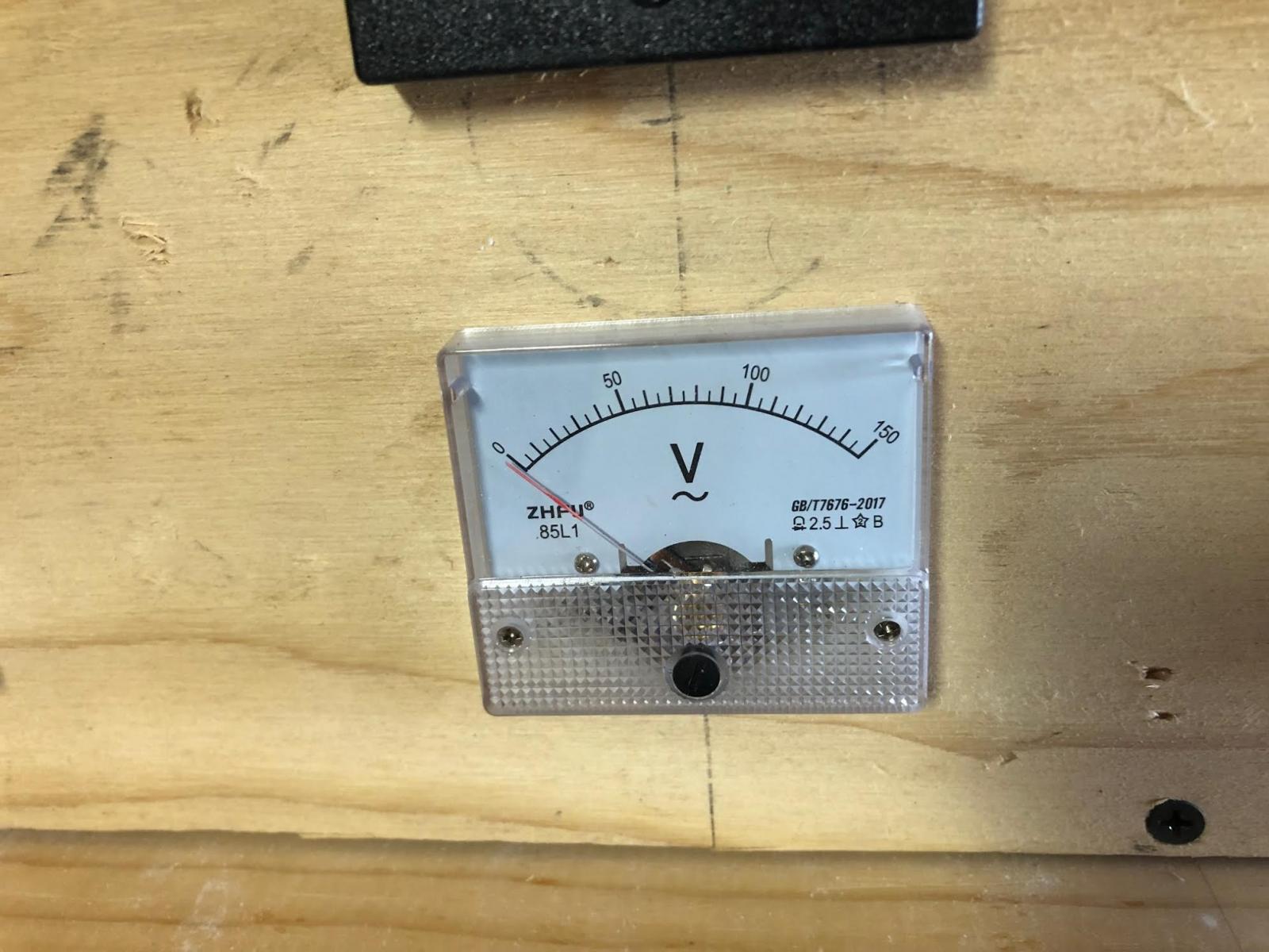

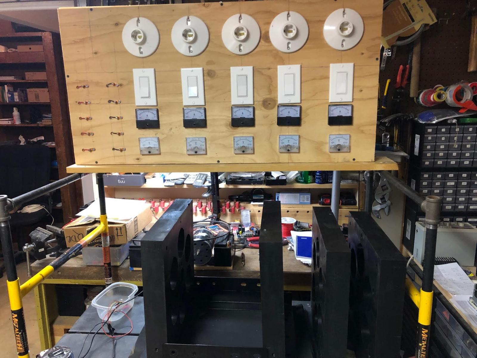

              2. I wasn't really thinking about my test board until I mounted it back on the cart I build the motor on today. I needed a BREAK from winding coils. I noticed that my gauges only go up to 150 volts AC, because my previous coils (with cores) only put out 120-130 volts and that's all I needed. But these new coils (with cores) put out 270 volts, so the meters won't give accurate information. That means I need all new meters. They are on the way.
              3. I was using one 300 watt bulb per coil (with cores) pair as my test load, and they were getting a bit over rated input, but they did fine. Now the new coils (with cores) will be outputting 400+ watts, so I need to find some 400 watt bulbs, or put a couple 200 watt bulbs in series. As you can see from the picture, my board is not set up for that. So I will be dealing with that tonight and tomorrow, either ordering some larger bulbs if I can find them on Amazon, or ordering the holders to wire two 200 watt bulbs in series. One way or another.

              Click image for larger version  Name:	Bad gauge.jpeg Views:	0 Size:	182.5 KB ID:	507634 Click image for larger version  Name:	Light Board.jpeg Views:	0 Size:	214.2 KB ID:	507635

                    Ten 200 watt light bulbs so I can put groups of two in series to deal with the higher voltage. That will take some drilling holes and running wires, but not too much delay. (They purchased these too.)
