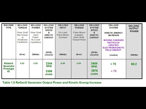

              Thane pulled them off and put up a single video. Don;t know why. My wife is a lover
              • Quantum motor
                  Quantum motor
                  Interesting... 90W out, 500W in, efficiency = 18%.... then he puts the 90W back into the motor and of course the prime mover will need less power to operate, only 400W in.
                  He is basically storing energy in his capacitive coil, which puts a load on the motor. So let's say that it takes 600W to run at a certain speed xxx rpms. Without that capacitive coil, it would only require 400W to turn the motor at speed yyy rpm, with yyy > xxx.
                  Use this as the starting point: 400W to turn the motor at yyy rpm. Then move his capacitive coil to the machine. This will load the motor, slow it down to xxx rpms and increase the required power to 400W to 600W.
                  And then the case where he is charging the battery: take again the starting point of 400W to turn the motor at yyy rpm, then apply the battery load, it will slow down the motor to zzz rpm (zzz < yyy) and require more input power (500W in this case).
                  And again, Pout << Pin
                  Where is the free lunch here?
