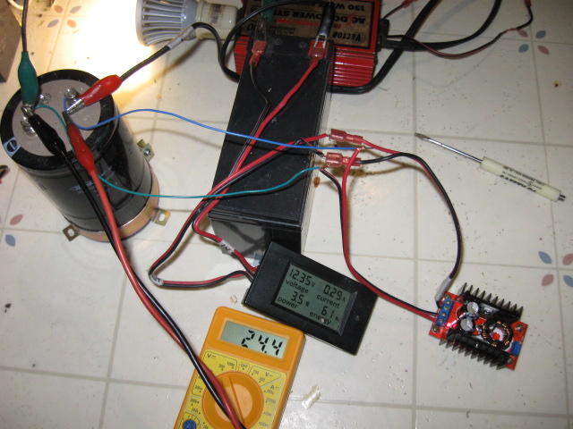

  • I realize that what I'm doing may not be directly related to the exact "replication" of Matt's work. I tend to focus on things I don't understand so I can learn. Then, I turn things around flip them over twist it all up so I can look at all angles of what I'm doing -
    Below is a picture of my spaghetti ball of wire, switches, batteries, transformer etc... that picture shows a complete balance of energy being shuttled back and forth between the batteries and cap bank. At 170 hz it holds at 25.7 on the batteries and 13.4 on the caps. The interesting part is that when I lower the frequency I can charge the cap bank while draining the batteries and raise the frequency I can charge the battery bank and drain the caps. There were no loads running during this test, simply a curiosity of anomalies I saw in prior testing. It appears to be acting as a resonant circuit between the batteries and caps through the coil - off resonance high or low we get a different directional energy shuttle. I can measure everything but the batteries so this leaves one variable that is unknown. My own little quest for some answers...
    So while pondering the tests, the 3 battery system and creating a potential difference it occurred to me that 2 batteries and a boost converter basically does the same thing.... so I scratched some thoughts on my white board then put together some quick tests... can anyone explain the difference??? The diagram shows a 2 battery system using a simple manual DPDT switch to shuttle the batteries - one is being drained while the other is charging.

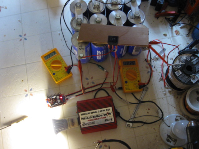

            That switch looks sweet ! I'd bet it's similar to that used in the vaping industry in the buck/boost units to drive the resistor coil. I've looked into those like it myself. If the MPPT controllers weren't so expensive it might be another viable tool for this type of transformation, they are quite efficient in converting voltages.

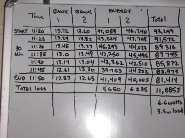

            Anyway, I did a 30 min test on the 2 battery ( used 2 cap banks ) and calculated the result.... not so good... to many conversions to eek out any gains.
            This afternoon I'll set up a 3 battery circuit with some watt meters to monitor it in real time. Similar to what you have currently going ( smaller scale ).

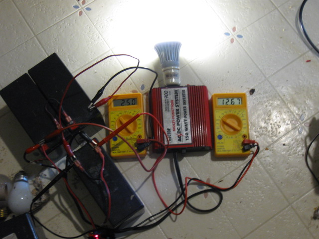

            • I've had Matt's latest variation running for about an hour, I'm using 3 - 8ah SLA's, a 150w inverter and a boost circuit as laid out in his diagram driving a 3.5 watt load on the inverter (LED bulb). I can confirm what he's seeing. Once you dial in the boost it runs pretty stable.
              It appears to run the inverter from the boost converter while the series batteries are offsetting any losses to maintain charge on the single. The boost converter uses X amount of watts to maintain the circuits needs at the lower voltage while boosting up the voltage at a lower amperage to maintain the difference. The only thing that gets used in the series batteries is what's needed to cover losses. Watts in = watts out - efficiency.
              I am humbled by its simplicity - A big hat tip to you Matt !
              I haven't put the watt meters on it yet, I'm going to let it run for awhile and just monitor it, I'll put the watt meters on it later tonight when I have some time...
              Edit: Update.... the single battery, although the voltage seemed stable was drained. At about an hour and 40 minutes the single's voltage started bouncing. Shutting it down I found the voltage had dropped to below 11 volts. The series batteries stayed at or around 24.9 by the end. So it is running the inverter from the boost charger and the single battery. This might not show up on high ah batteries for quite some time depending on the load. So next will be the watt meter set up to see whats going on....

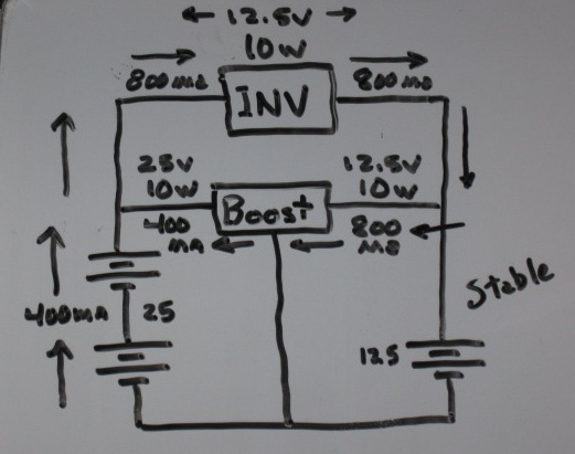

                    Like Matt said, you can adjust the boost to find the most stable area - you can adjust to discharge the single or to discharge the series. Finding a middle ground where both series and single are stable would require some very efficient circuits.
                    When you get to a point where the single battery is stable, not charging or discharging, then you've basically created a current loop between the boost and inverter. At that point the series batteries are supplying the extra amperage needed to sustain the loop. Quickie diagram below excluding any losses.
                    If you had 2 circuits that were 100% efficient - one, the boost circuit drawing say 1 amp input at .5 amp output at double the voltage and two, a buck converter taking the .5 amp converting it back to 1 amp at 1/2 the voltage feeding the boost you could remove the batteries for a theoretically endless run.
                    The key to longevity here boils down to the overall efficiency of the circuits and loads themselves.
                    The circuit I posted sometime back operates on a 50% duty cycle where the energy is shared through the coil and load during the on cycle and the off cycle the stored energy in the coil gives a small charge back based on the coils parameters ( .5 x LI^2 ) . The 50% duty alone would give the appearance of running twice the time of a normal load. The charge back cycle would allow up to 1/2 of the energy to be returned, in reality, you might be able to recover up to 25% of that half giving the appearance of even longer than 2x runs.
                    I think there may be some interesting possibilities in uniting some highly efficient buck/boost circuits. Possibly a buck circuit built into a transformer in place of the inverter...

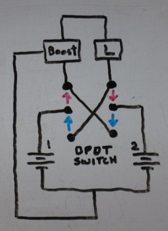

                              • Single battery and cap instead of the 24 volt series. Take note of the neg connections... use the grounds as they were intended on the boost circuit plus the bypass...
                                Even though the neg side isn't isolated the direction of currents are different. I set one up using only the neg of the boost and driving a 3.5 watt bulb required 5.1 watts. Adding the external bypass dropped the wattage to 3.5 watts. If you remove the bypass it jumps back to 5.1 and if you remove the booster output ground it jumps back to 5.1. The diagram below shows the negatives in place.
                                It took a bit to figure out as I tested amp flow in all areas of the circuit... if you follow the flow of the neg current through the boost you'll see it moves toward the charge battery - while the current flow from the high side through the inverter back to the charge battery is damped by the reverse current flow. Like wise if you don't use the neg on the output side the boost the ability to charge the series battery is damped by the same amount.
                                The diagram looks redundant with the extra neg connections but once you follow the amp flows and read the meters it all comes together....
                                One other quick note - it's much easier "dialing" it in with a watt meter connected, you simply adjust it to the lowest wattage possible.
