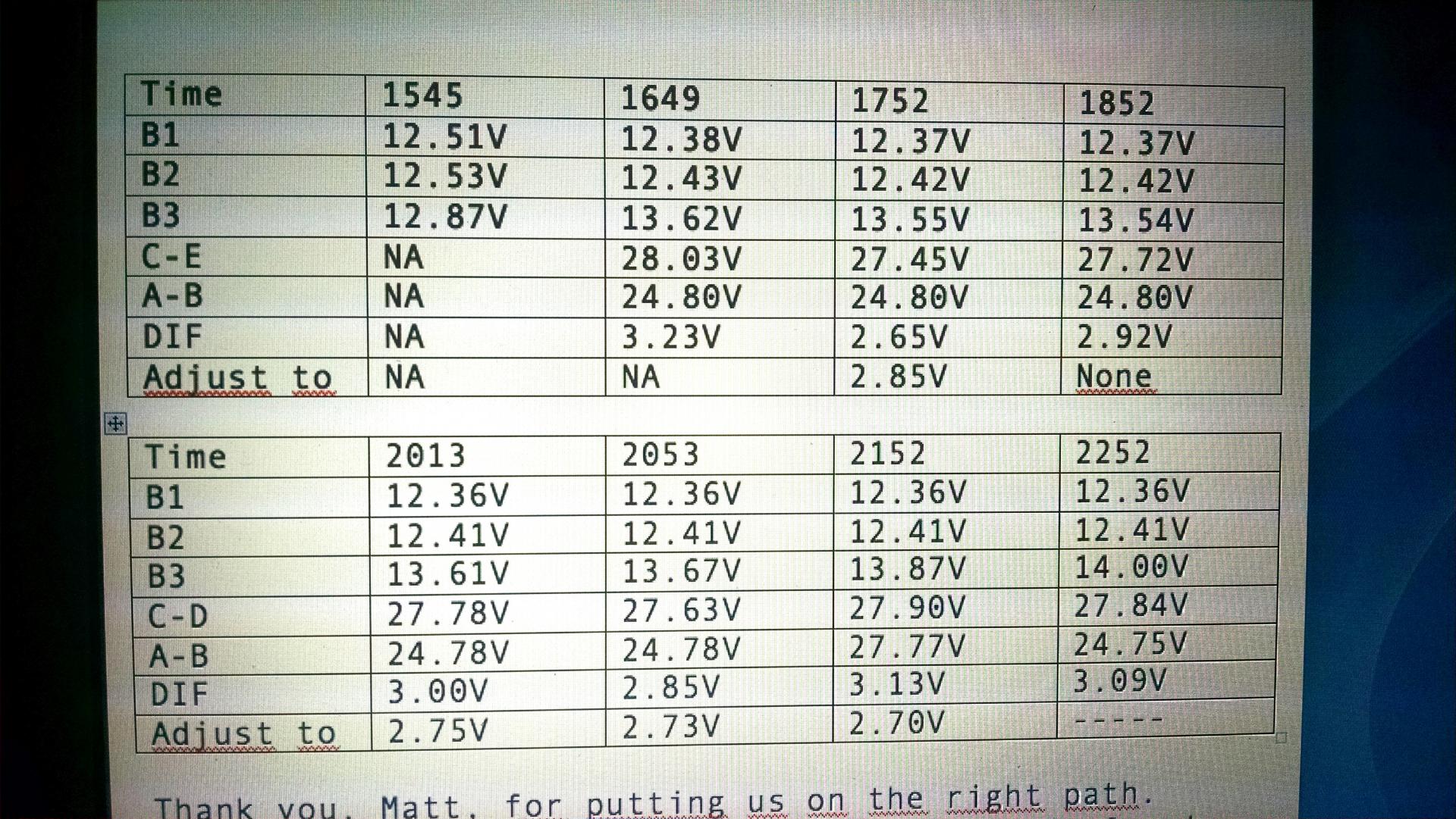

        • Hello gang, 06-19-16
          I have been busy with a couple of related projects, but with Matt giving so much great input here, I couldn’t resist to try what he suggests. I have messed around with the 3BGS for some time and had mixed result, but nothing that I could consistently reproduce…until now.
          [In testing the day before, I had started with lower voltage levels and had amp meters between B2 and the Boost Module and between B3 and B1. This messed with the running of the system causing it to cycle high current/low current, oscillating about every 4 seconds. So I took them out and things ran fine, but I had poor results.]
          Using three identical 230 CCA batteries, the oldest of which is two months, a Boost Module, and a tiny Radio Shack motor, I charged the batteries and let them rest over night and come to rest at 12.81V, 12.82V, and 12.83V. I ran some tests before getting the following.
          Below I attached a pic of the setup and a drawing to help explain how I measured the effects. I found that from B to C was a 2-3V difference and from C to D was over 14V. So I measured C to E and subtracted A to B (the Primary voltage) which usually rendered numbers between 2.5V and 3.2V. I found that if I set the Boost Module so that the number was near 2.5V the Primaries both went down, and if I set it near 3V they went down, but B2 was higher than B1. So I reasoned that at 3V, the energy went all the way through to charge them, but was too big a drain (because the Boost Module was pulling too much). So I set it around 2.7V and then I got consistently good results…the Primaries held right where they were and B3 charged higher.
          I measured every hour and found that if I started with the difference at about 2.75V, it would be up to around 3V alter the hour of running, so I would have to re-adjust it to 2.75V. The following are my measurements:
          Current: 80mA
          Time 1545 1649 1752 1852
          B1 12.51V 12.38V 12.37V 12.37V
          B2 12.53V 12.43V 12.42V 12.42V
          B3 12.87V 13.62V 13.55V 13.54V
          C-E NA 28.03V 27.45V 27.72V
          A-B NA 24.80V 24.80V 24.80V
          DIF NA 3.23V 2.65V 2.92V
          Adjust to NA NA 2.85V None
          Time 2013 2053 2152 2252
          B1 12.36V 12.36V 12.36V 12.36V
          B2 12.41V 12.41V 12.41V 12.41V
          B3 13.61V 13.67V 13.87V 14.00V
          C-D 27.78V 27.63V 27.90V 27.84V
          A-B 24.78V 24.78V 27.77V 24.75V
          DIF 3.00V 2.85V 3.13V 3.09V
          Adjust to 2.75V 2.73V 2.70V
          (I tried adjusting the columns on the above, but they just all went back together. Sorry. I'm attaching a pic of them below.)
          Thank you, Matt, for putting us on the right path. Without your input I would have probably never found the balance.
          Bob
