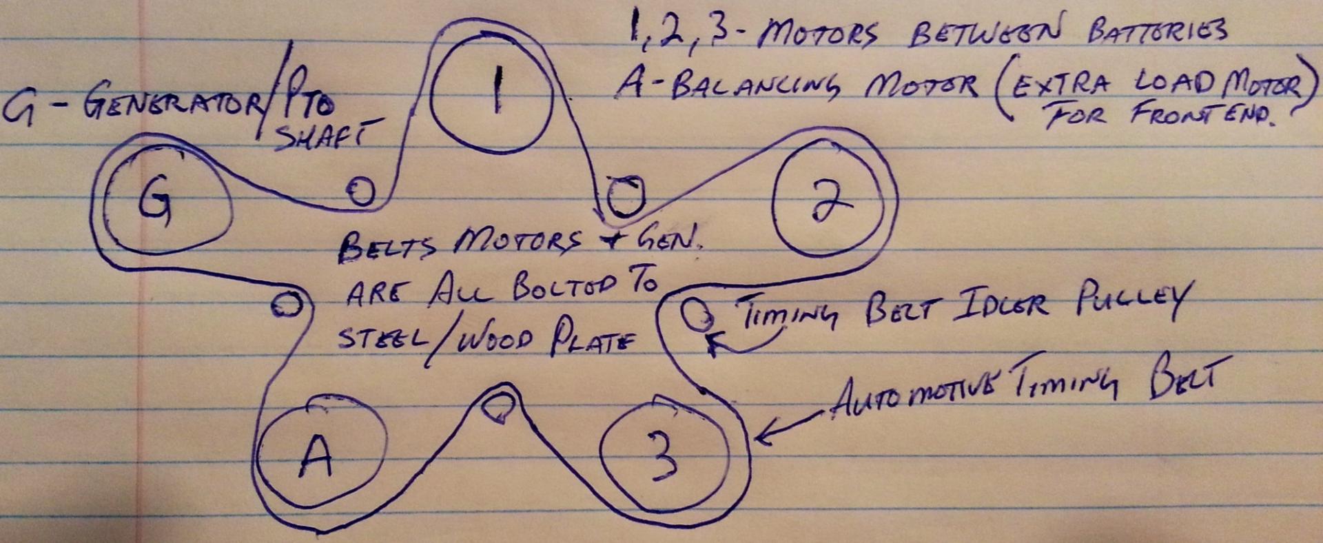

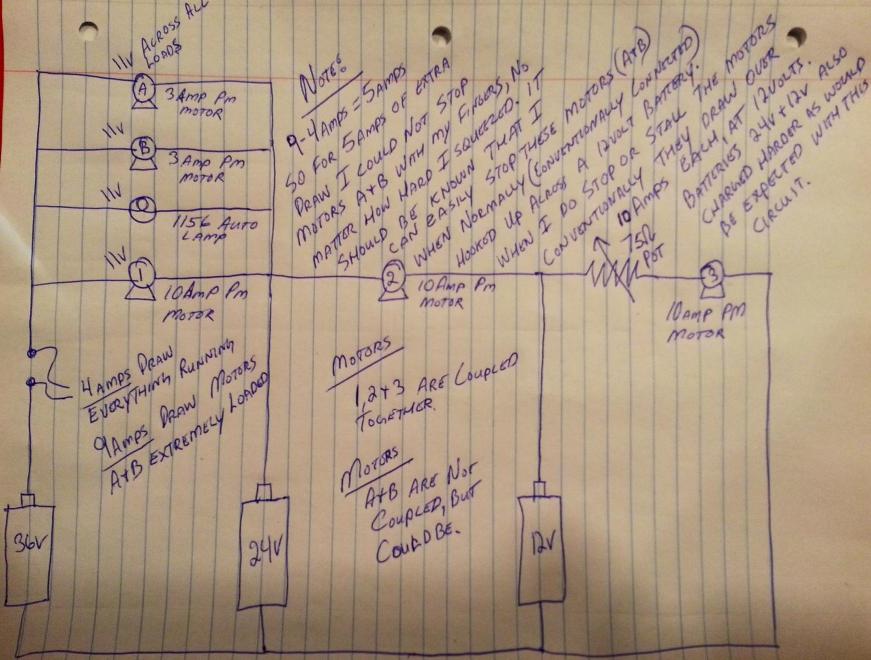

Motor 1 can supply current to motor(s) A and/or B. It acts as a generator getting its power from the shaft coupled motor(s) 2 and/or 3. Current from motor (generator) 1 will not pass through your ammeter and fuse.
