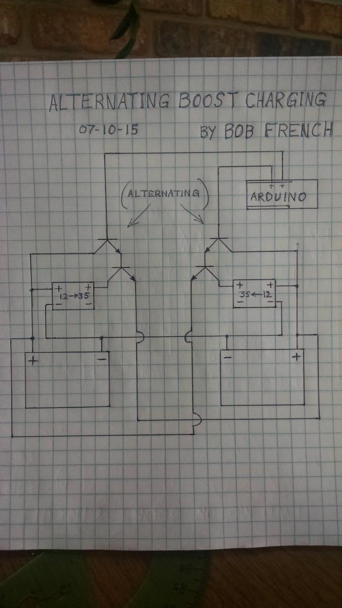

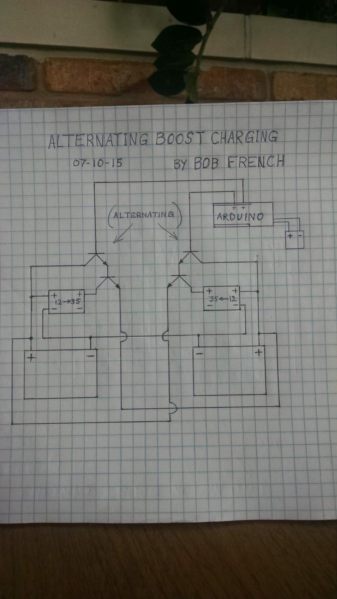

Yes I seem to get the most efficient charging with these batteries if I charge the cap to about 14.75 volts and dump it more slowly than I was. I am also charging with a longer dump time. I am now using a 15 millisecond dump and 60 millisecond recharge time. Over all current seems to be the same but the battery is taking it better.
I think what I am mostly doing right now is just reconditioning the charge battery. Once I get that done then I can see if this circuit will be able to charge batteries and sustain itself too.
I was able to get the resistance down to 10 ohms by turning the boost circuit down quite a bit. But that also seems to have improved my run to charge current ratio. I am still not able to find a combination that will let me do away with the resistor totally. I did try adding more resistance but that did not improve things any.
I am trying to take it slow and easy on reconditioning this battery. I am almost out of batteries to play with. Time to take the shorted ones back to the salvage yard and trade them for some more to play with. I really think this circuit might be the best one I have found for reconditioning the batteries even if it does not prove to be self sustaining.
