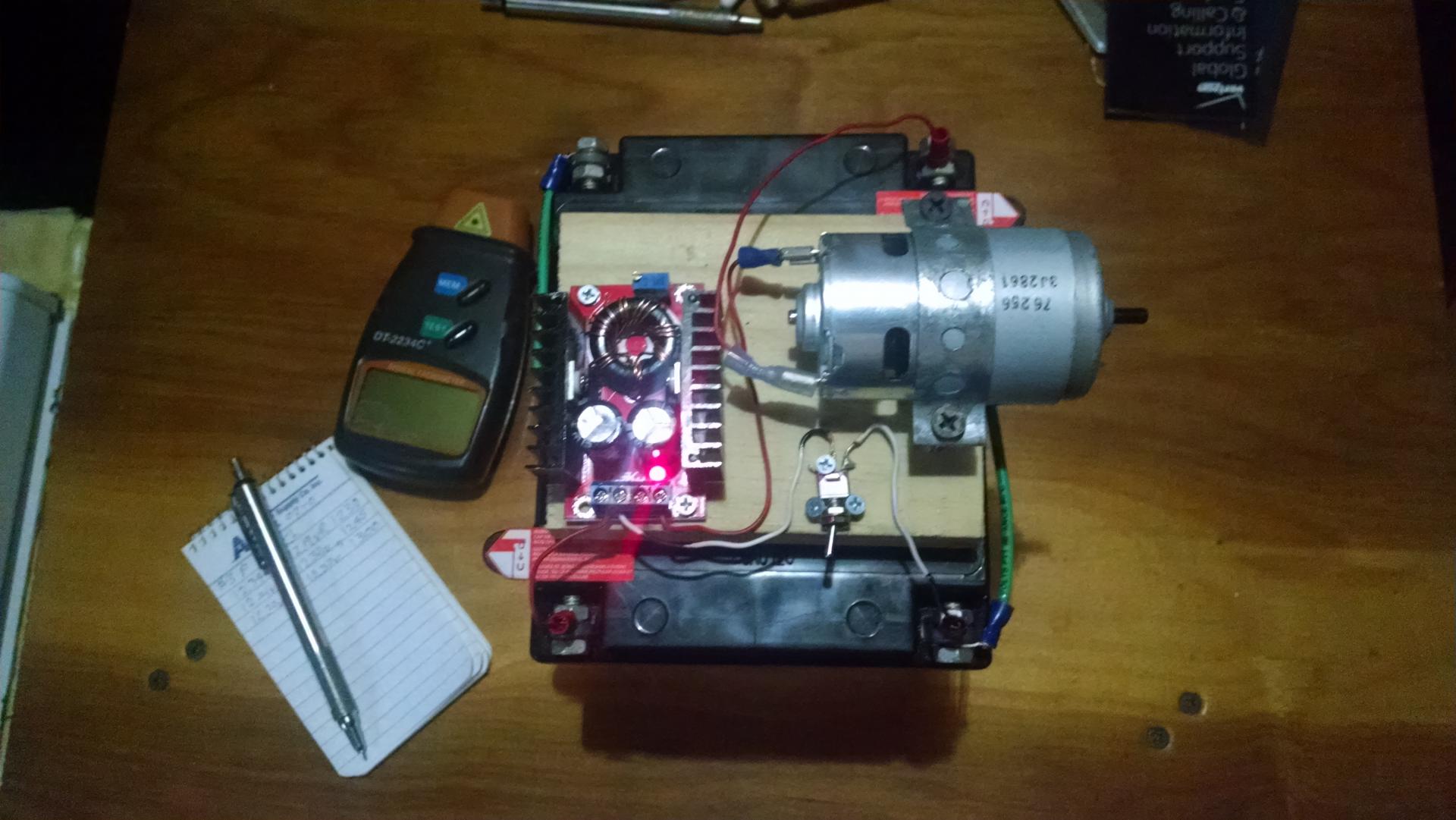

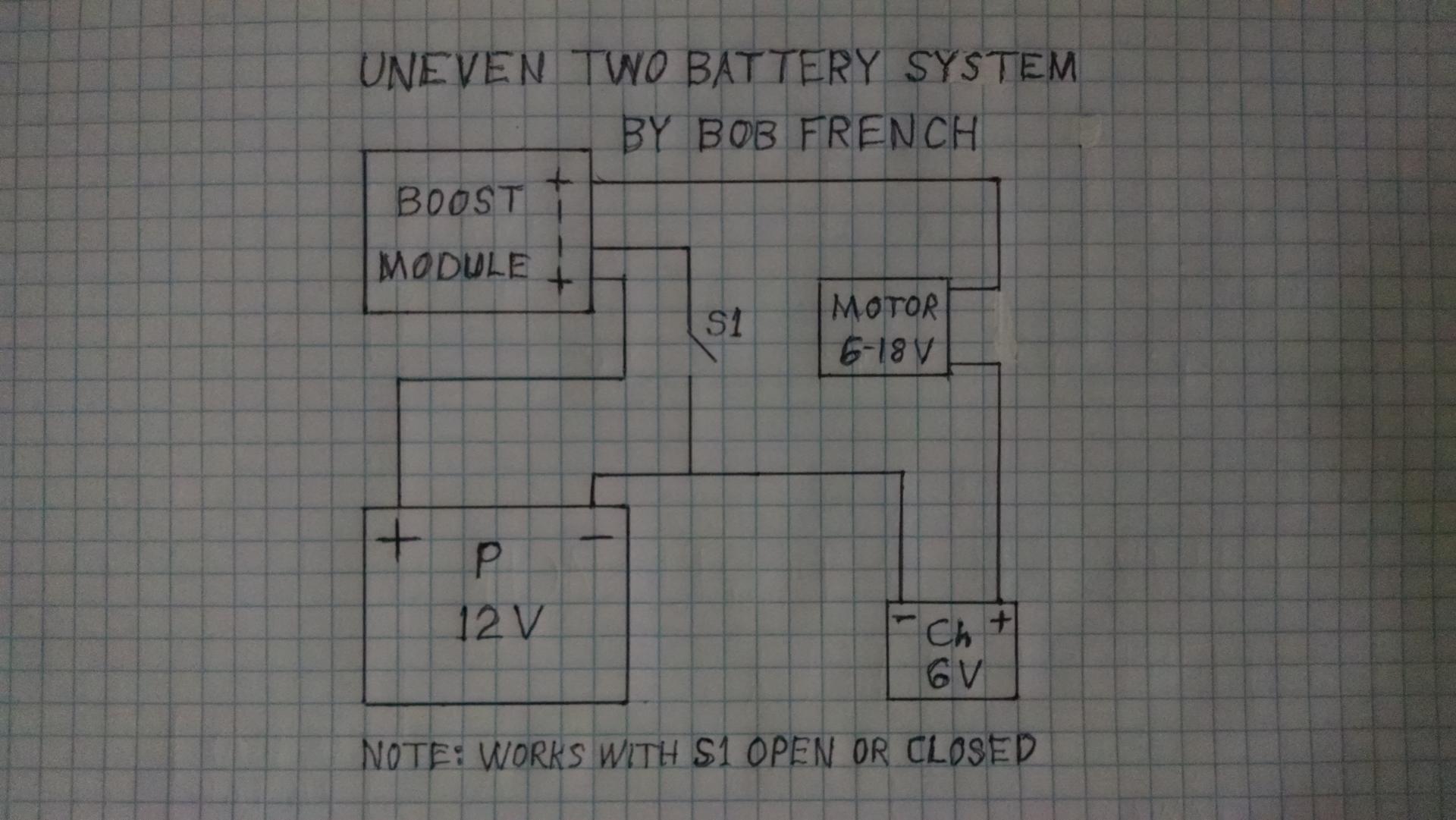

I included a circuit in the above post for a 12V Primary charging a 6V battery. The main thing I wanted to say about it is that even without energizing the Boost Module the circuit runs the motor and charges. With the switch off, when I made the last connection while setting up the test, the motor started and the 6V battery voltage increased. I turned the switch on and the Module energized and the motor sped up. Very weird. Apparently, the Module's circuitry allows something through if the potential is there. (?) Or maybe it's just magic.

Hello Bob. Thanks for the details of your testing. In your 12V to 6V battery setup, the reason you saw the motor start and the 6V battery start charging when you hadn't switched on the boost converter yet is because a non-isolating boost converter (also called a boost switching regulator or boost DC to DC converter) has a direct connection from it's input Vin + terminal to its output Vout + terminal, typically through a low forward voltage drop diode such as a Schottky diode. If you see the attached schematic of a basic boost converter circuit it should be clear why this is the case.Originally posted by [email protected] View PostI forgot to talk about this:

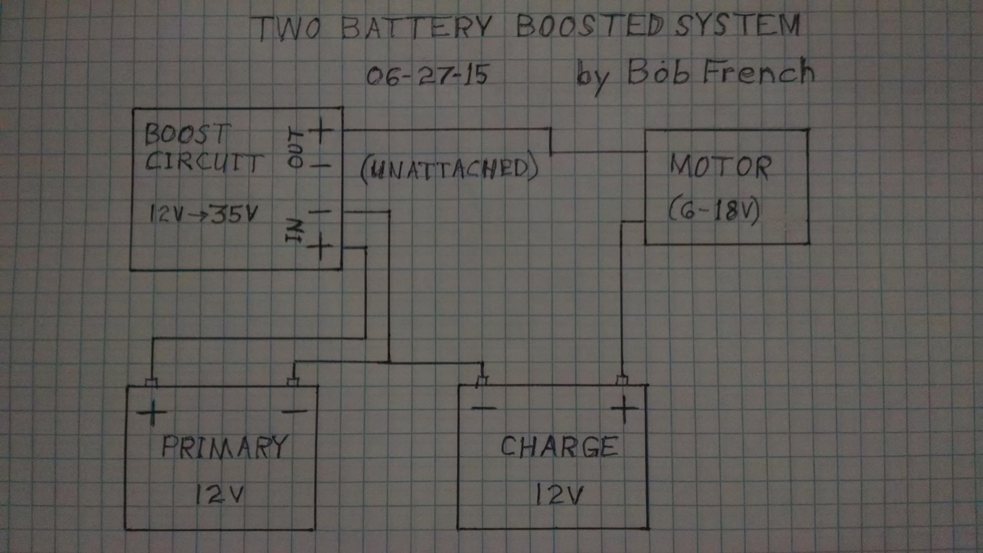

Thanks for the info Bob. I noticed in your schematic and Dave's that the ground out is not used. Then in Levels' schematic it seems the ground is common? It has me confused how can the circuit even do anything seems the Pin would just go directly to Pout. I'm pretty slow when it comes to electronics or anything else for that matter.

Hello shylo. With the boost converter, when the transistor is pulsed on it pulls more current through the inductor, and then when the transistor is switched off the diode collects the high voltage back pulse from the inductor and stores the energy in the output capacitor. Since the inductor back pulses are higher voltage than the input voltage to the boost converter, the output voltage on the boost converter output capacitor is higher than its input voltage when the boost converter is powered on. To adjust the output voltage on the boost converter, the boost converter typically adjusts its transistor pulsing duty cycle. In Bob's 12v to 6V battery circuit, the negative terminal on the primary battery is the common ground for the whole circuit, so that is why you don't have to conect the boost converter output negative terminal to anything, as its input negative terminal is connected to the primary battery neagative terminal when it is switched on.Originally posted by shylo View PostI noticed in your schematic and Dave's that the ground out is not used. Then in Levels' schematic it seems the ground is common? It has me confused how can the circuit even do anything seems the Pin would just go directly to Pout.

Level, thanks for the Boost Module explanation and circuit drawing. So the motor runs off the potential difference of the batteries (minus some losses) with the switch open. I kinda figured it was something like that, but didn't know the Boost circuitry. I agree with you about the inaccuracy of just measuring the voltage of the batteries, but at this point, it's just a convenient indicator. Because we're swapping the batteries back and forth, the true test is whether they go up or down in the long run.
