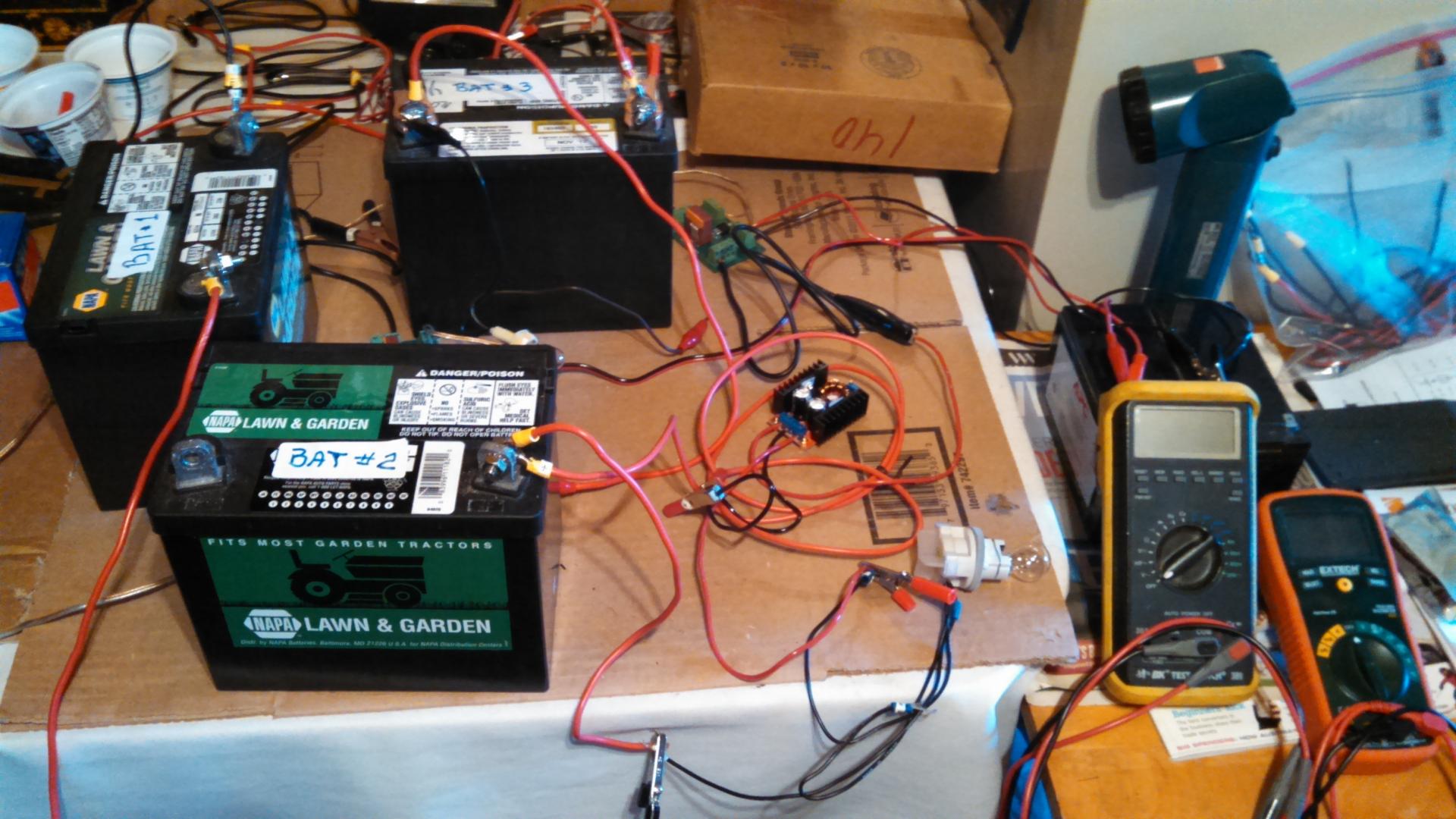

    Greetings Gentleman,
    Accomplished the first test run of the booster circuit with a 6 watt dc bulb load. The basic arrangement used 3 NAPA Tractor Batteries (one turned out to be way weaker) and adjusted the converter to a stable voltage that allowed for a 1 hour test run.
    Measured the amperage between batteries position 1 and 2 along with amps between 1 and booster converter using externally powered Hall type amp sensors.
    Mucked around a bit for a stable system and decided to use a booster voltage of 13.64v where the weaker battery worked fine. Not perfect but a good start.
    Time B1 B2 B3 Boost A1 A2
    Start 12.70 12.85 12.52 13.64 0.0 0.0
    6:53 12.20 12.51 13.31 13.64 0.64 0.65
    7:11 12.20 12.51 13.46 13.64 0.63 0.74
    7:31 12.18 12.51 13.68 13.64 0.65 0.70
    7:53 12.15 12.51 13.94 13.64
    Resting voltage after 1 hour - B1 12.50, B2 12.77, B3 12.78
    Discharge B3 (Charge Battery) down to 12.20 volts with 8 watt load for 1:21 hrs and rest B3 for 3 hrs with final voltage at 12.52 - same as starting point. Ah value is not an accurate reflection due to initial setup time
    As an end test cross check on the amperage draw used an 8 watt bulb on B1 and B2 for several minutes to stabilize voltage. B2 at 12.51v and B1 at 12.17v - close to both test end run volts. Rest voltages returned to above noted values.
    Attached are test assembly pic and .pdf's of real time amps at noted data times - quality not great here but will correct.
    Happy 4th,
    Yaro
    3BS 1.pdf
    Last edited by yaro1776; 07-05-2016, 10:26 AM. Reason: TYpo - Reverse B1 and B2 values for rest voltage
