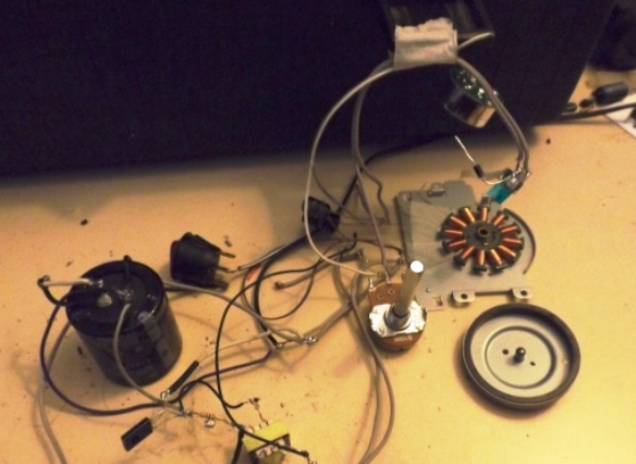

                        • hi all.i got a floppy d d spindle motor,as in the pic,running today. 1 iso trafo runs it on 1 phase.being unloaded it spools up like a jet engine.
                          it was easy to get into.the hub slides off and the stator is held by 2 screws.there were 4 connections to unsolder to separate the stator from the pcb. the motor is wye connected with an extra wire to the junction. i left the pcb out and soldered 4 short lengths of .4 enam copper wire for a low profile leadout,taped down firmly,(not much of a gap there).i put heatshrink over the joins.
                          i'm still trying to get it to run with the dual iso trafo circuit,with a view to generate with the other 2 phases.
