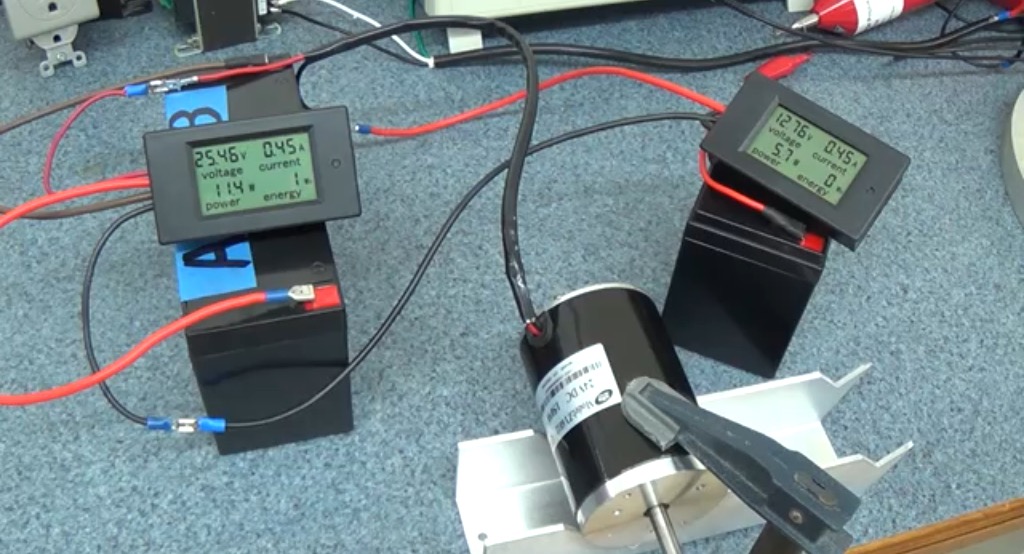

  • Originally posted by ricards View Post
    the current is the same as because the shunts are in series and series circuit have constant current.
    A current shunt (or meter) is always positioned in series no matter the circuit.
    the meter is designed to measure watts accurately on a conventional circuit.. the 3 BGS is an unconventional circuit. we expect them to measure incorrectly.
    Then what we can do is remove the "unconventional" part of the circuit (battery 1 & 2) and charge battery 3 directly from a power supply and see if the results are any different.
    Link to demo video: https://www.youtube.com/watch?v=V1V8HVx3y0Y
    Luc

        Sorry ricards but I don't know or understand what this test proves? since of course if the input voltage is lowered the motor will reduce in speed and or come to a stop if there's not enough difference in voltage between the input and the battery under charge.
        The watts meter on the charge battery is only measuring the voltage across the battery (under charge or not) and is what I'm most interested in measuring. The motor is before the watts meter so it has no effect to the meters voltage reading other then when the input voltage gets high enough the battery starts to charge and therefore displays the voltage increase of only the battery.
        Luc
          Hi gotoluc,
          Nice video and great presentation, however.. the meters are designed to measure a "voltage" Potential on a "Shunt" that is inside the meters, which usually is a resistor.
          its not that the meter is lying (like that is even possible).
          its only that the meters are measuring the voltage drop on the "Shunt" and not the voltage drop to the battery.. because they are made that way..
          think in terms of pressure, as voltage is analogous to pressure.
          If I connect the metal plates (+) which has 24v worth of pressure to the pipe going to the negative (-) which has 0v of pressure then you will have 24v worth of force going through the pipe,
          but if you connect the same 24v worth of pressure through a pipe into another plates which has a 12v worth of pressure already in it..
          you would only have a 12v worth of pressure going into your pipe because there is already a 12v of pressure opposing the 24v of pressure on your source..
          the meter was design to just multiply volts and amps.. It wouldn't know if its measuring the voltage correctly..
          in summary we shouldn't be too dependent on the meter's they are measuring tool humans invented over a certain arrangement. it shouldn't in any way "define it all".
          Yes I have to agree with you. I would take an ordinary DMM and measure across all the points of the system, I went through all this some years ago and did post in this forum.
          Also look at the voltage across battery 2 only, and what happens over an extended run.
          Mike
            Luc

                • I see nothing wrong with Luc's test it is accurate 100% as I have found the same thing on the bench when using a straight DC motor or straight DC load between the positives and using such a high discharge rate, far beyond the C-20 rate. There is nothing wrong with his experiment period, it is a closed loop system that cannot have gains.
                  However there can be additive gains to the system if one uses the pulse driven, make or break circuits among other things to get gains. This then becomes an open looped system that will show gains, as the Benitez patents suggests. I am not sure why this back and forth is going on with Luc's experiment.
                  Dave Wing

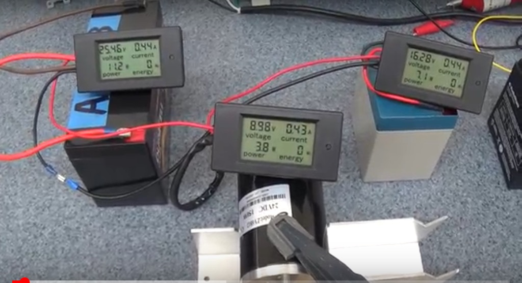

                    • Thanks jettis for coming forward and sharing your research experience.
                      I made another video based on a suggestion of using 3 watt meters. Basically adding a third on the motor to measure its activity.
                      I also took a few extra minutes to quickly give you a glance of my chosen lifestyle which gives me freedom to work full time on research and experiments 50 or more hours a week which I still enjoy doing after 10 years of living this way. I also did this because I've seen posts on this forum that I'm paid $1,000 a week to spread disinformation and so on.
                      The only disinformation is fabricated by these individuals.
                      Link to video: https://www.youtube.com/watch?v=-3P3E6pNGdI

                      • Luc,
                        You say your only purpose is to see if this really works or not, yet you continue to run the SAME experiment that you have already been told time and again is destined to FAIL
                        1. The batteries are too small
                        2. The load (motor) exceeds the C-20 discharge rate
                        3. You never rotate the batteries through the 3 positions.
                        4 That is NOT a Matt modified pulse motor.
                        In my book, all that you are proving is that you can’t or WON’T listen. That’s what makes me question whether your real intent is discovery or disinformation. I don’t really care. I am still waiting for Aaron to lock this thread. Someone else can fight the battle of dealing with folks like you and I will go on to other things, like making some money off the things I have that work. I can leave knowing I did my best, and you can leave believing you are correct and we’re both happy.

                          • Luc,
                            Look at your meters on the small side battery in each test and notice the watt difference on each meter, in these two screen shots of your two separate tests. What do you see?
                            Dave Wing
                            • Second image. Maybe I am out to lunch but it seems to me that the lower CEMF from the rotation of the motor and the high value of the low side voltage has done something to your input watts on the low side of your system.
                              Dave Wing
