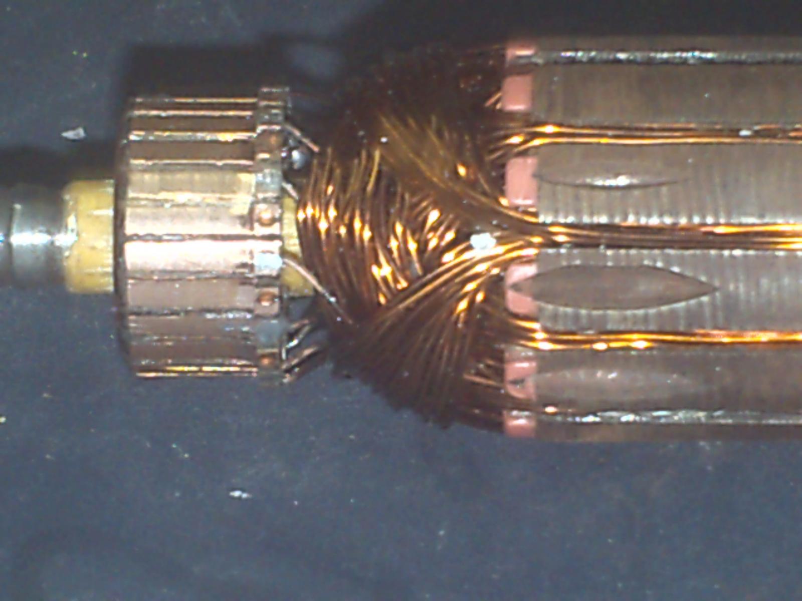

    Hi guys,
    Been a very busy day so just now got back to the computer. Shylo I like what you did with that rotor. Can you post a picture of the commutator end. I am trying to figure out the best way to connect those coils to the commutator. I have some ideas but I would like to see what you have done if you don't mind.
    Since I will be getting 3 of the scooter motors to play with I want to wind one of them like you have done shylo and wind one like mbrownn shows in his drawings. Then maybe that will help me understand better how the different kinds of winds might affect the performance. My motors are supposed to be in Saturday so maybe I can get started soon on trying out some of these ideas.

      If you have any more information or pictures about the rotor you posted a picture of please post that information in my thread about open discussions so we don't cause confusion in this thread. I agree with mbrownn we don't need for this thread to wander off in a lot of other directions like some of them do. But I am interested in learning more about how you connected those coils to the commutator.

        Its the simplest winding possible. Starting with the armature in front of you and the output shaft facing you, and an armature slot at the 12 0'clock position. Solder one end of the wire on a commutator segment at the 9 o'clock position. Run the wire to the slot at the 12 o'clock position and wind the wire through that slot, past the armature shaft and return down the slot at the 6 o'clock position. Continue winding loops passing either side of the armature shaft until the slots are full, and then pass the wire to the commutator segment at the 3 o'clock position. Rotate the armature until the next slot is at the 12 0'clock position and repeat. Continue this process until all slots are filled.
        On my armature I had double the number of commutator segments as armature slots. This makes the sweep angle smaller. I found that if it had the same number of commutator segments as armature slots the sweep angle is too big.
        The reason for connecting the segments at 90 degrees to the coil is so that the wires are close the the armature and do not get thrown out too far when the armature is spinning. Its as simple as that, but I am sure you know removing the old armature windings can be a challenge.
        Obviously we are separating the two halves of the armature into two poles, this is why it is best to have an even number of armature slots.
