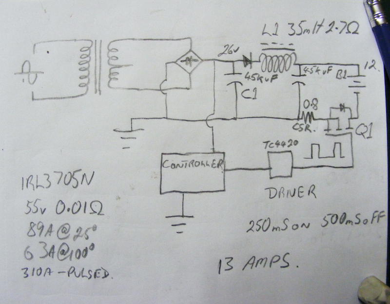

Yeah thats right I think 2 stage "Cheers to Matt" that last post blew me away with the circuit with 3 coils one wound ccw and the other 2 cw?
Let me know if you build one after supper. I could do it with 2n2222 and a 2n3906 maybe or some small transistors.
I think the cap at the top represents the cap bank?
