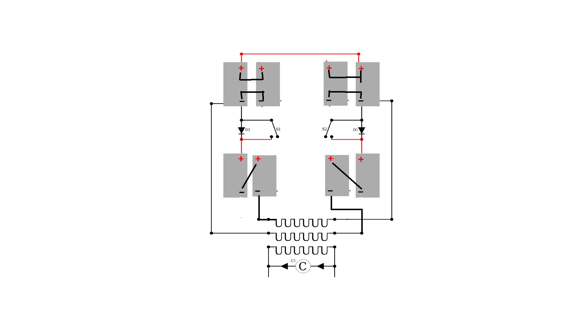

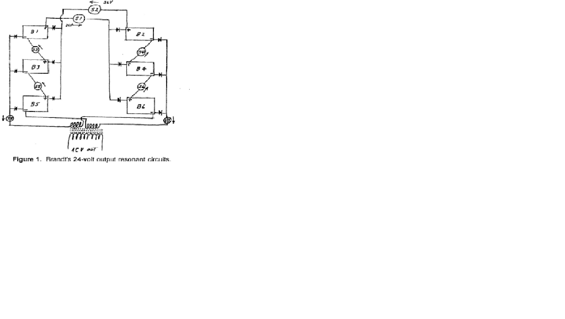

            • Hi Matt,
              Pluggin' along.
              Wanted to ask if you had tried something.
              In the Brandt schematic(attached) he's switching 36v into 12v.
              Have you tried this?: (attached)
              Might get a little "sparky"
              Thanks,
              Donald

                            • I once setup a 6 x 12vdc 7ah battery setup that sorta emulated the brandt config, tho it was using my own circuitry to control the on/off times of the two halves of the circuit. As long as theres something in series, and no connections being made or broken when the switches are thrown, no sparks come out... tho if you have very low resistance everywhere in the circuit you might overcurrent and blow it out. Really depends how much Amps are allowed to flow as to if anything will get destroyed when the switch gets flipped.
                              Made some weird waveforms from that setup... still have it collecting dust in the garage here somewhere.
                              Cheers.
                              Gene
