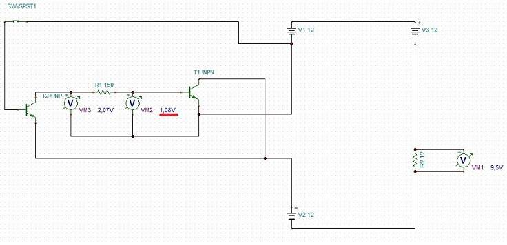

            So we started first to debug the 3 battery setup. We removed the toroid from the system, and replaced it with a 12 ohm power resistor for easyer measuring. Voltage in the resistor was the same as in the toroid's secunder.
            At the PNP's collector (between the NPN's emitter) we measured ~1.3V square wave. But between the NPN's there was only 200mV square wave, seems like the transistor was not fully open. We was tested with bigger and smaller transstor pairs, tryd smaller resistor between them, but the BE voltage remaind ~200mV.
            I attached the Tina simulation of this, but the underlined voltage are obiously wrong in the simulation.
            Have you got any idea about what cen be wrong?

                    • I still don't understand all your your explanation of the measurements but sounds to me that the problems mostly are in the toroid transformer. So work on that if you can.
                      But keep posting when you get a chance, I'll help the best I can.
                      Matt
