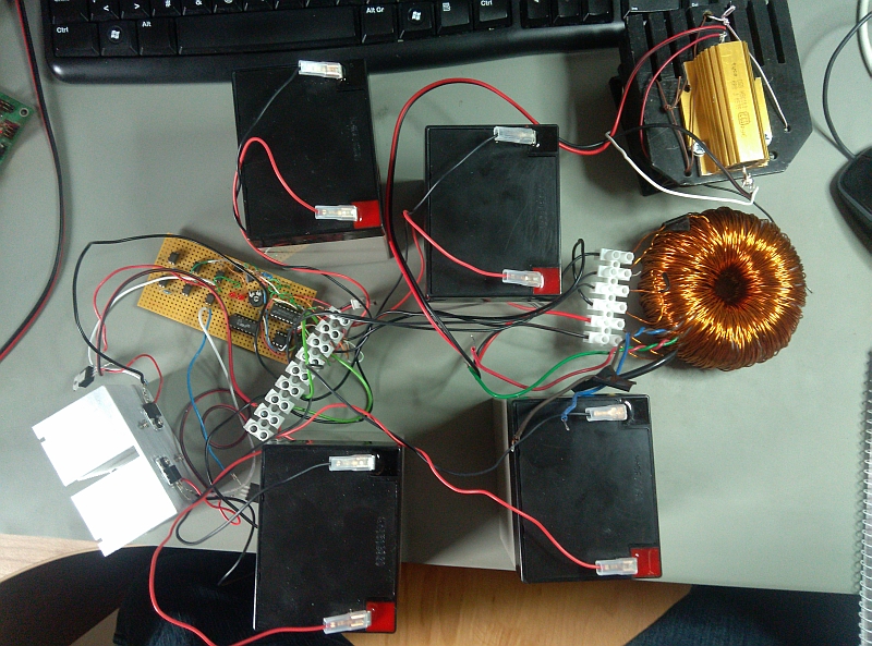

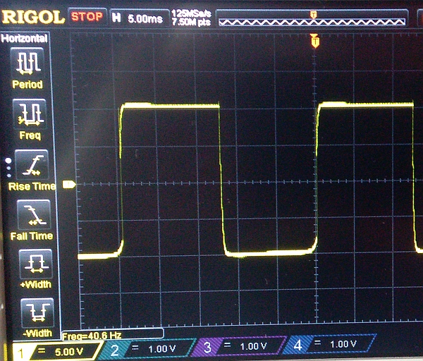

Some time passed since our talks, but now i'm back with a working switch. I was able to put the third winding into my toroid and i let the circuit run for 6.5 hours.
This was the 'smaller one' with the optocoupled switches from your guide (page 25, with simple analog timer based switch). The batterys are 5Ah brand new ones. I do not used a graetz + puffer in the secunder winding, instead i simply used a 6.8Ohm power resistor for load.

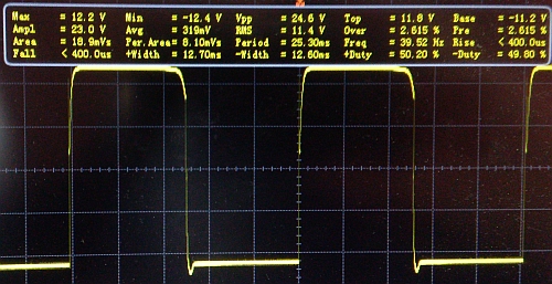

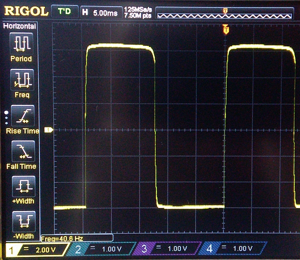

~40Hz was the perfect switching frequency for maximum output voltage. That's about 20Vpp (with the load attached) - 6.8Vac according to a DMM.

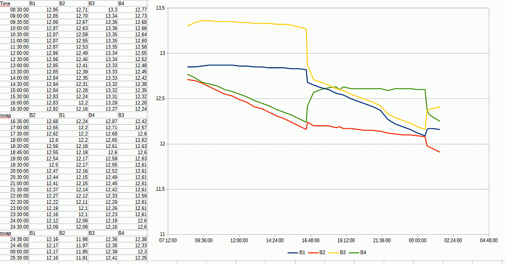

What i experienced so far:
The 'upper' batterys are mostly kept their voltage, while the other two are drained as you can see in the first picture.
That draineing of the 'lower' two batterys will stops somtime?
