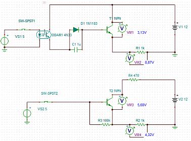

      This makes things a bit more clear. If i do an upgrade on the driveing part of the schematic, i will get more speed and less voltage loss on transistors. I will rebuild my circuit in that way.
      Even tina simulation shows great decrease in voltage loss.

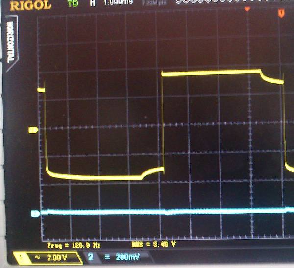

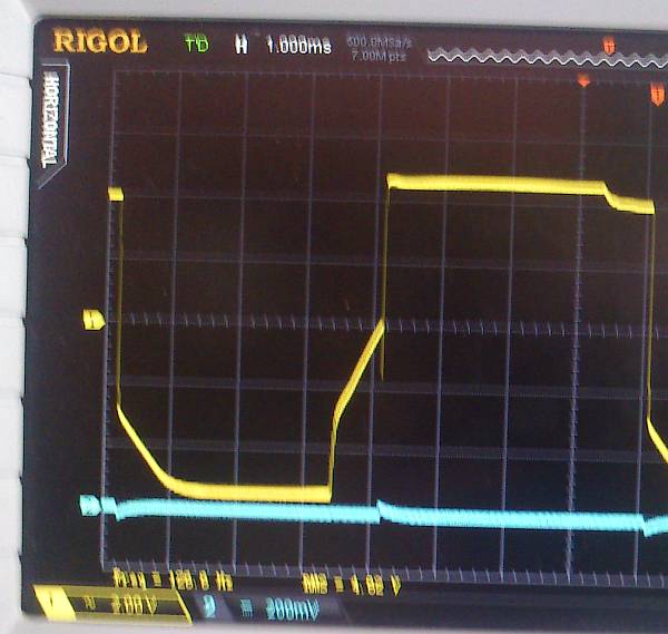

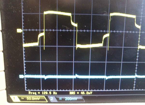

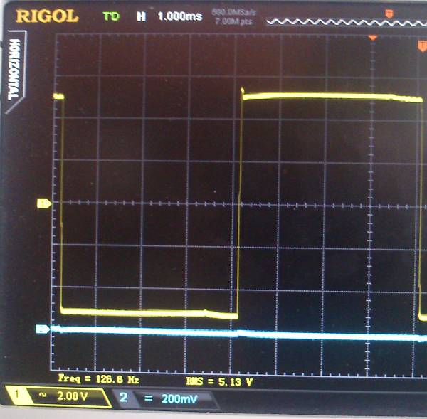

          2 of the 4 batterys drained 0.2V while the other 2 drained just 0.01V after 3.5 hour of running (same 1.4Ah batts, equaly charged at the start). The load was 24ohm resistor, the output voltage was 6.7 - 7.3Vdc (with puffer capacitor)
          I think some of my optocouplers are needed to be replaced, because of what you can see in B-E driveing2 and graetz voltage pictures.

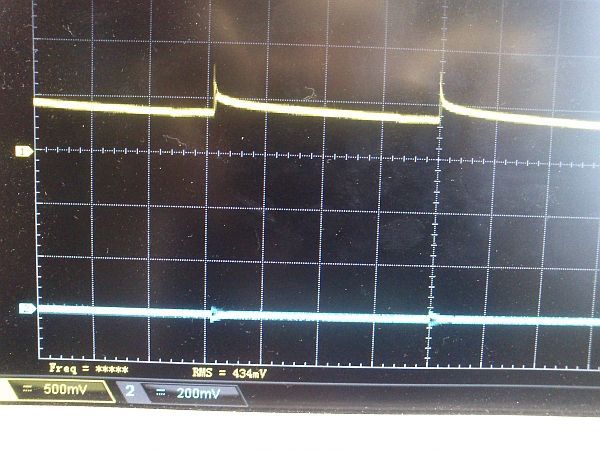

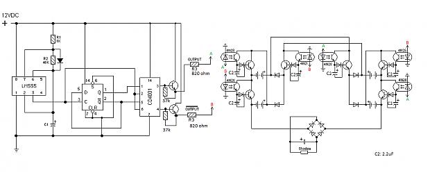

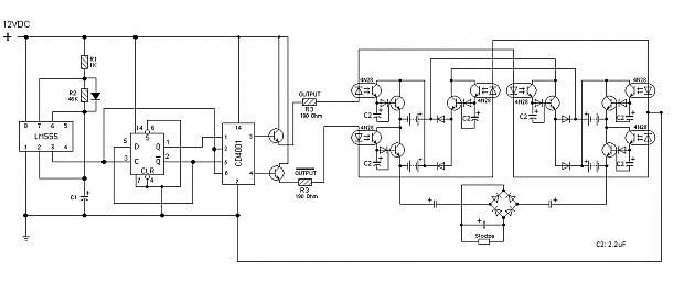

                          Well, i think the opto coupled tesla switch is a no-go. I do made a lot of modification but the optocouplers are performing very poorly and different to each other.
                          *see circuit diagram

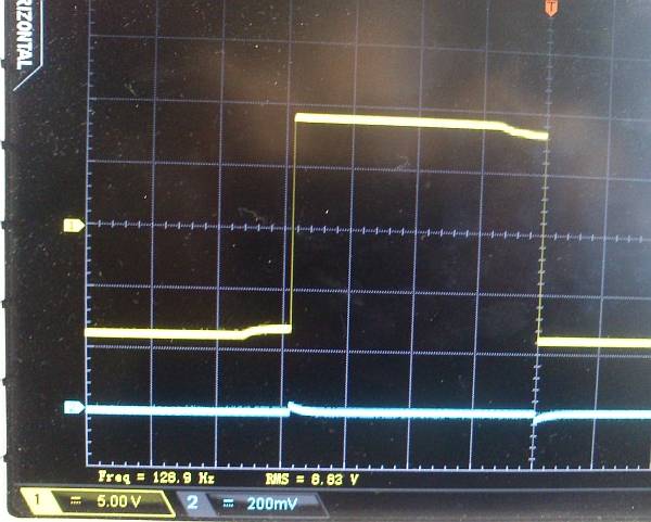

                          One thing i'm sure is serial driveing of the optocouplers are a bed thing, because of the second and third one gets a not perfect square wave (falling edge will be a slope), so i connected them paralel, with a proper input resistor.
                          I do also put depleter resistor to the driveing transistors, so now all of the opto's are got the same and perfect square wave, but the C-E voltages are still shows erratic breakdowns around the falling edge of the squars.
                          Currently i'm thingik about changing the opto's to small transformers (along with the cap's and diodes, and connecting the secunder between the B-E pins). We got a bunch of 600ohm telephone line transformer with a ratio of 1:1, they are ideal for the job. If it's not working, than i will move to plan B and build your circuit.

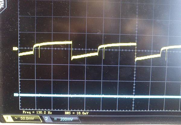

                                Tuned it to .017sec on times. Scope shows good switching.
                                Strange mm readings.
