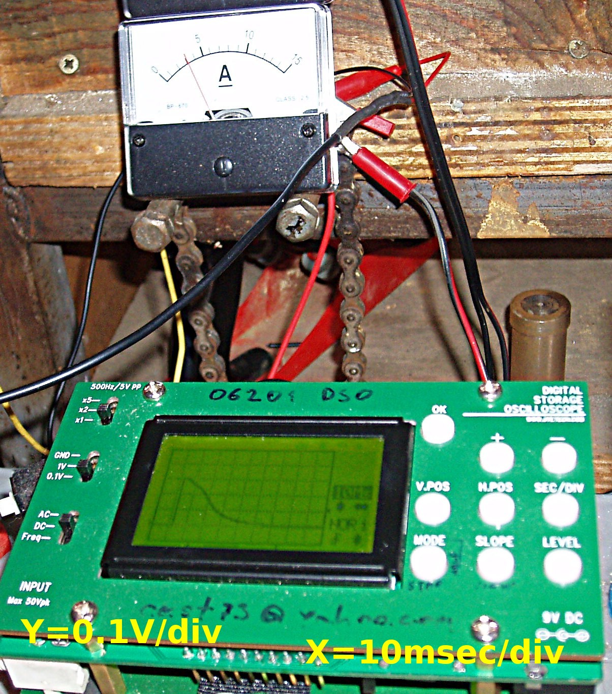

As I do not have a adjustable power supply I had to limit the input with the pulse width of the picaxe.My input is a 20V, 8a notebook power supply and I had to limit the input to 3A on the ammeter with a 60msec pulse from the picaxe. The output pulse is also 60 msec as I found that is adequate time for the caps to discharge into the battery.
