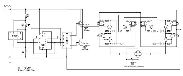

          Years ago i built Jetjis's tesla switch what i found in Panace university's pdf in the 28. page. (see attachment)
          For lack of proper tools it was laying in my desk for years, but now i started to finish it. There are a little difference between the original and the current version of the ciruits because the CD4001 lonely was not able to drive 2 * 3 otpocouplers, so i added 2 small signal npn transistor for boosting the output.
          In the original circuit, the decoupling capacitors was withouth a value but in other designs on the pdf i found 0.5 - 1F capacitors for the same job. I'm currently lacking of these big capacitors (will try to get some), so i put 10.000uF capacitors instead.
          I think the decouple capacitors are wery important, because the output voltage gets 0.5V higher when i switched from 1000uF decouplers to 10.000uF decouplers.
          Currently i was able to get about 6V DC and 240mA flowing trough 24 ohm power resistor.
          For the initial test, it was running it for 45 minutes with small, 1.4Ah 12V batterys, but i noticed only a 0.01 - 0.02V drop on their voltage while run.
          The timer in this circuit are able to produce 10Hz to 300Hz precise square wave, but i think the weak points are the opto couplers, because some of the 6 2n3055 transistors are get not perfect square wave in ther base when using 30Hz+ for timeing.
          In the next week i will do more testing. I hope there are somebody who also built this circuit and can thell his experinece with it.

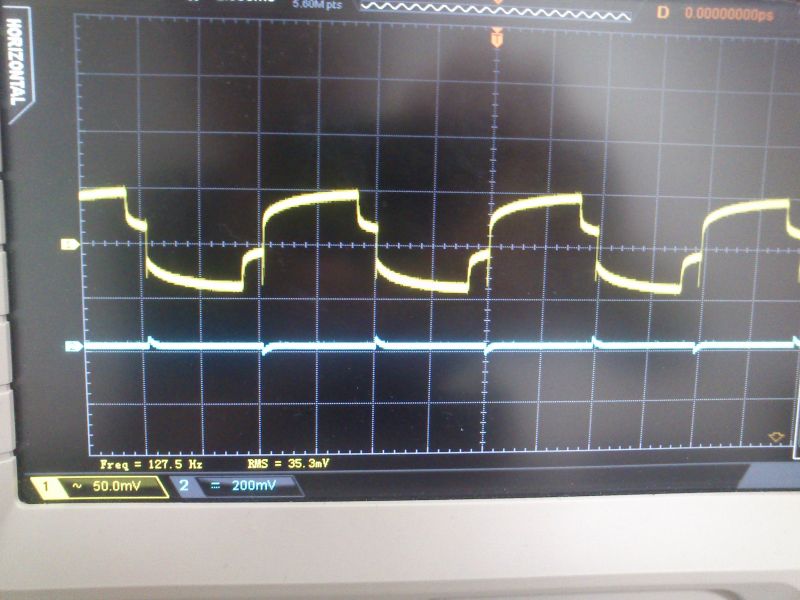

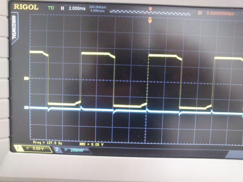

            • The right side, like in the picture. In around 10Hz, the sq wave input on those transistors are almost perfect, but not exactly. Raising the frequency causes the right side of the wave to get worse.
              What do you mean about different driveing?
              • So instead of using 2 resistors to drive the base use this:
                The capacitor with the negative only needs to be 1 UF 10 volt or so. This helps drain the base quiker.

                  Does Jetijs or somebody actualy built that circuit what i attached? So far i had no luck with it. I tryed out couple of settings and loads, but in every way the batterys are started to depleat.
                  My first attached picture shows the driveing signal of one of the transistors (B-E voltage), the second one shows the output in the Graetz's AC inputs and the third one shows what's in a battery's poles (ac coupling).
                  Based on Bedini's driveing technik, i think it's needed to redesign this circuit. My opinion are the 2 resistor driveing methode causes that so low output voltages. And it's also needed to use other transistors like mje13009 or mjl21194 instead of my cheap 2n3055's.
                  • Tell ya the truth I don't know how his worked out, not sure if anybody had luck with it.

                          Its not the 2n3055 its the resistors. The turn off time is too slow.
                          Personally I use fets and IGBT's now with drivers.
                          The pulse width is also important, as some of what you are seeing is the impedance in the batteries kicking in. A decline in current and in a OPEN situation also a decline in current flow. Batteries can usually handle up 30 MS pulse then the impedance kicks in so the potential drops at that point.
                          The batteries will actually tell you when you have hit that point but it is algorithmic in nature and depends on the situation you are using to charge it.
                          The current Tesla switch (Benitez Switch) I run is heavily dependent on filters to decipher the signals coming back from the battery to determine the pulse width and shape. All that can make a difference.
