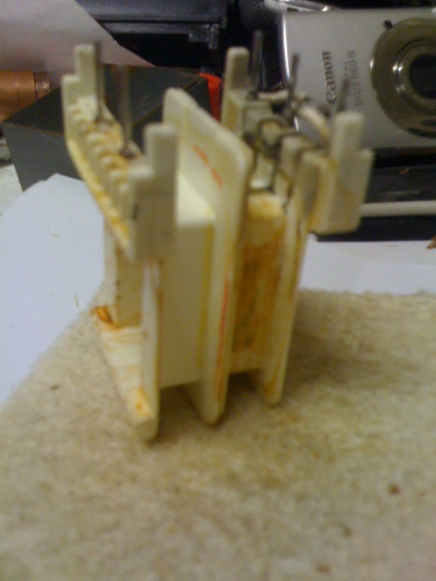

    I've managed to remove the laminations and removed the 2 coils.
    As you can see from the pic, there is a seperator in the centre of the spool.
    Guessing that this will need to be renmoved before winding the trifilar coil.
    Picked up a little trick to make it easier to reassemble the laminations. Instead
    of peeling out every individual piece, leave the cross piece adhered to its
    neighbour "E" piece.
    Thanks, Garry
