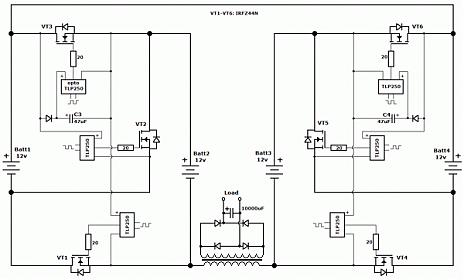

Good Evening All,
I'm no PICAXE expert but the code would appear to be:-
DO
PULSOUT B.1, 250
PULSOUT B.2, 250
LOOP
The B doesn't seem to be strictly necessary as the circuit works either way.
I'll be following Matt's tuning instructions tonight and will report. I would strongly suggest you follow the Start Up and safety checklist!
Richard
