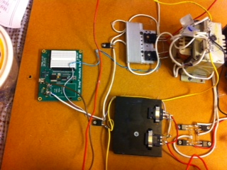

Here's the code we're working on to use up and down buttons with the Stamp so you don't have to type in new numbers every time to change the pulse time. Attach the transistors to pins other than 14, 15. If you want to change the starting value or the amount of the Increment/Decrement, change it in the CON line. For those of you who do NOT have your chip attached to a board and have to pull it to reprogram it every time, something like this might be extremely useful because it would allow you to change values on the fly.
