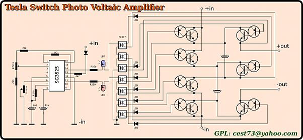

    Brilliant work Stevan
    Parallel to series. This is way he calls it the Tesla charger
    Very clever switching using a npn on the high side instead of a pnp like in the bipolar switch.
    I always wondered how to do that high side switching with npn bipolar transistors. I see now how it works as the battery + at that stage is at a lower voltage than the cap + side.
    Your circuit also show what JB said about using the pnp with the npn to get a faster rise time, instead of using the parallel cap and diode.

    Very nice piece of work Stevan
    It reminds me of John's patent, the one I had persistent thoughts about
    I even made some changes and replaced Mosfets with MJL's (don't like mosfets) but didn't attempt to build yet and didn't share the circuit because it is modification of John's patent. I believe it is from 2003.

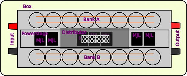

  • StevanC
    replied
    Originally posted by Bit's-n-Bytes View Post
    Outstanding StevenC. Are the main Caps 4700uf's
    Just a great job. Good work.
    Bit's
    Hi Bit's
    Each and every one is 10'000 uF @20V (=cheap) or 50V (initial testing)
    So it's
    80'000uF each bank
    40'000uF @40V in series (to battery)
    160'000uF @20V in parallel (from PV or PSU)
    AND
    they fill up to 18V not higher (ever)
    And they dump to 55% "SoC" of the receiving battery, not lower (about 8V) (ever)
    AND
    usually they swing 10...12V back and forth (yep, 2V only)
    Stevan C.
