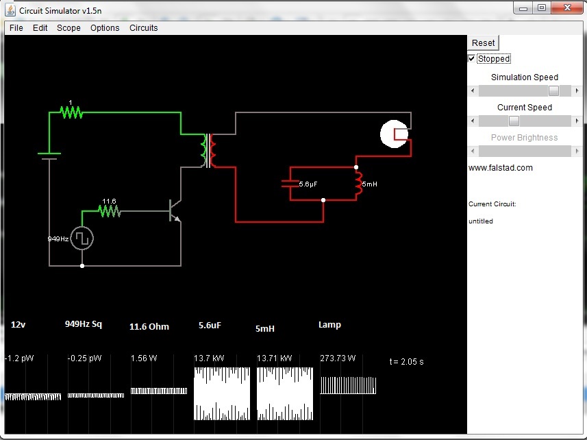

                    Hopeful skeptic, I like it. I do have one other question here. At the moment, I am currently running a electronic ballast, output is 30watts at 600Volts DC at 40Khz, then I run that through a flyback(with diode). Then I have 5mh-15mh coil(tunable with ferrite rod) and anywhere from 1 nF to 20nF from my homemade HV capacitors. Mathematically it should be close to resonance for 40Khz.
                    But resonance is so specific, I just wonder what is the best way to tune it?
                    40Khz + 5mH + 3.17nf = resonance?
                    LC Resonance Frequency Calculator at WhatCircuits.com
