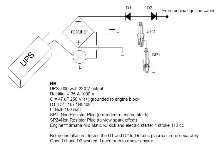

Hi Revizal,
Great work! Can you post the exact schematic you have on that bike?
Originally posted by revizal View PostInspired of Ozicell video's, I posted a video on youtube to get the real effect on plasma ignition system. We can show the original ignition spark and compare to plasma ignition. Still by using 47 uF 250 volt with power AC supplied 220 V (0.45 A). The 2nd spark plug connected in seri to the original spark plug. In this setup we could view the real spark effect. Now, I'm sure this setup runs on high frequency based on engine's RPM. Capacitor could not fully charged at high frequency. I though small capacitant in high voltage capacitor is better for such application.
YouTube - Motorcycle Plasma Ignition (Clear Effect)
regard,
Revizal.Sincerely,
